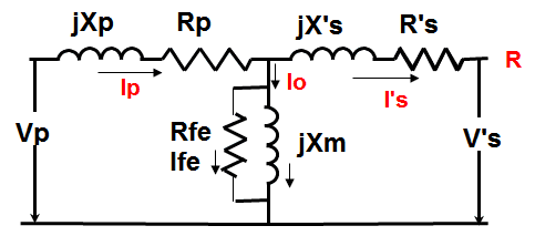

The magnetic flux in the core is considered constant. So if the secondary circuit is open- that
means i2=0- then the flux in the core will be Io*Np/Rc [Rc=reluctance].When reclosing the secondary circuit the core flux stays the same Np*i1/Rc+Ns*i2/Rc=Np*Io/Rc
There are a few ways to present the transformer magnetic circuits and the inductances in a transformer.
In electric power engineering the Steinmetz Equivalent Circuit is employed.
Never the less you need here to know Rp,R’s,Xp,X’s and Xm and Rfe [the linkage reactance and the equivalent resistance of the core losses] and Vp-of course.
