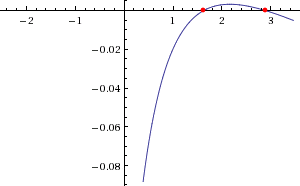

The solution to this equation is approximately y = 1.5.
Chet
Here's the WA graph for ##\displaystyle \left[\frac{ln(1+y)}{y}-\frac{1}{1+y}\right]- 0.213 ##
So, there are two solutions.
