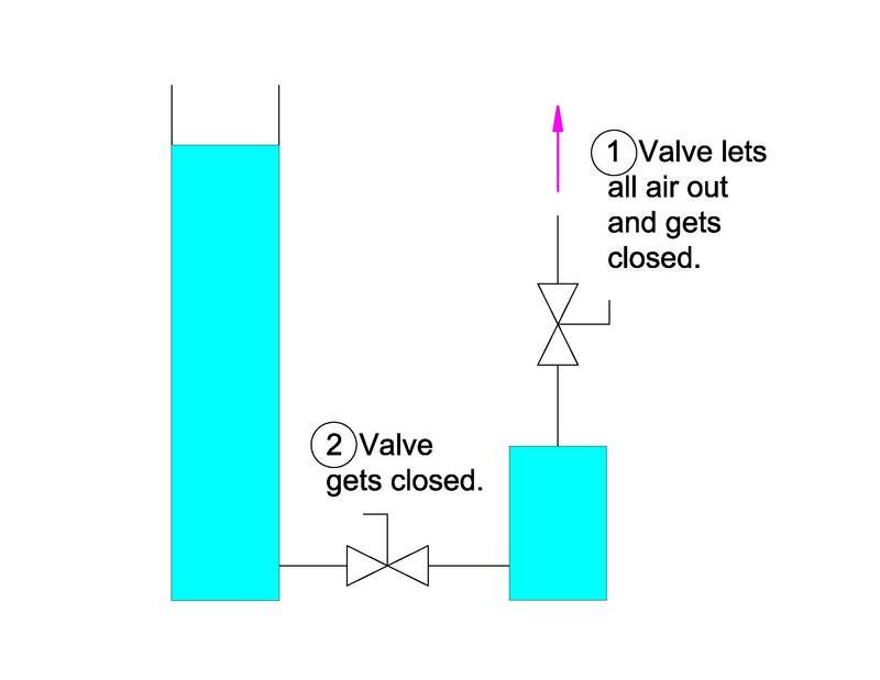

Will your responses change if we replace that sliding gate with a shutoff valve?
I don't see the correspondence between the two cases.
We are trying to visualize the lack of dependence between the condition of a valve (closed or open) and the values of the hydrostatic pressures in the points of the fluid located on both sides of that valve, and next to it.

In this case, the only function of any type of valve is to isolate that volume located at the very bottom of the cylinder filled with water.
It seems to me that @abrek incorrectly believes that, once closed, that valve also reduces the hydrostatic influence that the rest of the water located above that volume had previously exerted on the bottom one.
Likes russ_watters
I agree. That’s why I posted #13. The basic question is if the pressure at the bottom is indeed reduced, at what point during the partitioning does this happen?
