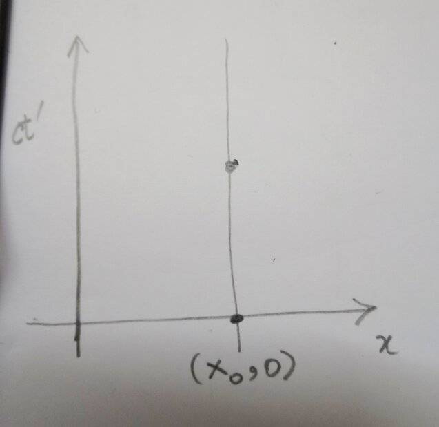

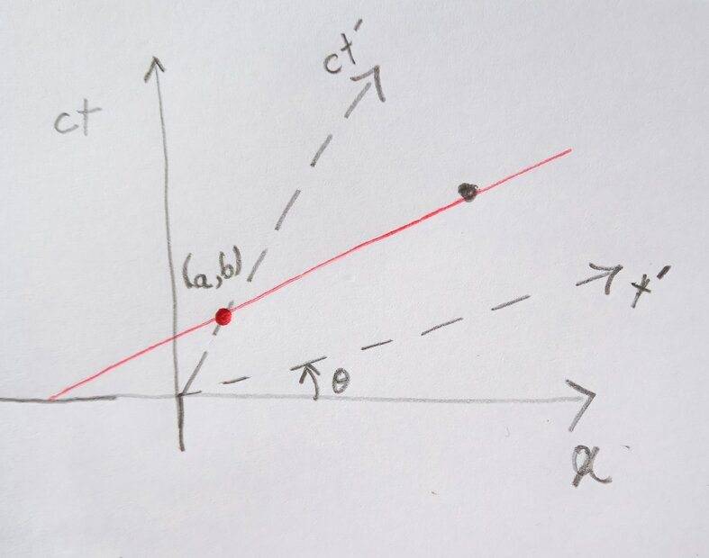

Ok is this how we interpret the space-time diagram: Given a point as shown in the figure, we find the projections of that point on the axis, in our case we've oblique axes, then the coordinates are given as:
##\begin{array}{l}
c t^{\prime}=\sqrt{a^2-b^2} \\
x^{\prime}=\sqrt{c^2-d^2}
\end{array}##Now let's say I've another space-time diagram as shown
In order to find the space coordinate of the point shouldn't I first find the projection on the ##x## axis and then write : ##x=\sqrt{x_0^2-0^2}##,which is simply how we used to do in euclidean geometry.
Yes, that still is the same.

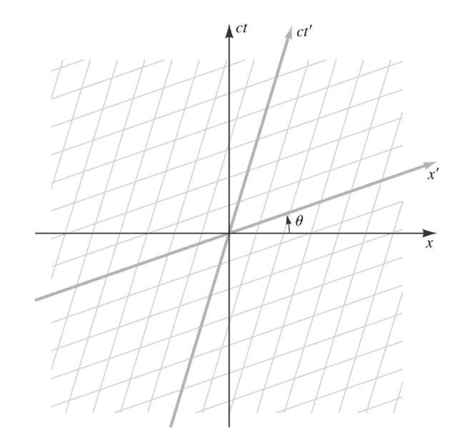

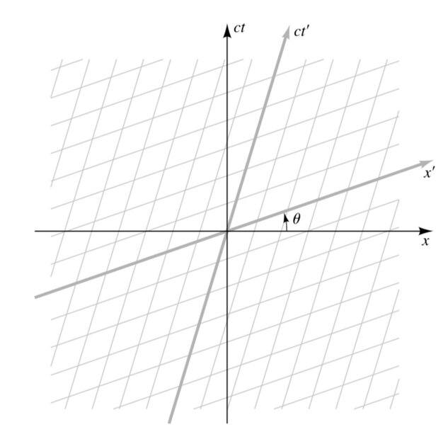

I still don't understand how the angle between the two x and x'axes is ##\theta##?
Book writes
"FIGURE 4.13 A Lorentz boost as a change of coordinates on a spacetime diagram. The figure shows the grid of ##\left(c t^{\prime}, x^{\prime}\right)## coordinates defined by ##(4.18)## plotted on a ##(c t, x)## spacetime diagram. The ##\left(c t^{\prime}, x^{\prime}\right)## coordinates are not orthogonal to each other in the Euclidean geometry of the printed page. But they are orthogonal in the geometry of spacetime. (Recall the analogies between spacetime diagrams and maps discussed in Example 4.1.) The ##\left(c t^{\prime}, x^{\prime}\right)## axes have to be as orthogonal as the ##(c t, x)## axes because there is no physical distinction between one inertial frame and another. The orthogonality is explicitly verified in Example 5.2. The hyperbolic angle ##\theta## is a measure of the velocity between the two frames"
The transformation is given as
##\begin{aligned} c t^{\prime} &=(\cosh \theta)(c t)-(\sinh \theta) x \\ x^{\prime} &=(-\sinh \theta)(c t)+(\cosh \theta) x \\ y^{\prime} &=y \\ z^{\prime} &=z \end{aligned}##To find the angle ##x'## axes makes with ##x## axes I use
##0=(\cosh \theta)(c t)-(\sinh \theta) x## to get its slope as ##Tanh(\theta)## and hence the angle is ##{Tan}^{-1}(Tanh(\theta))## but the book says the angle is ##\theta## ? What did I do wrong?
##\theta## is a hyperbolic angle, not a Euclidean angle. The angle ##\theta## you show in your diagram is a Euclidean angle, but that's not what ##\theta## is in your book.
You treated ##\theta## as if it were a Euclidean angle; that's what using the inverse tangent function is doing.
Likes vanhees71, Kashmir and topsquark

You used a circular inverse. It should be hyperbolic. I.e. ##{\tanh}^{-1}(\tanh(\theta))## and not ##{\tan}^{-1}(\tanh(\theta))##
This is hyperbolic geometry. Intervals are given by ##s^2=-t^2+x^2## and correspondingly all of the trig functions are hyperbolic as well.

PeterDonis said:
##\theta## is a hyperbolic angle, not a Euclidean angle. The angle ##\theta## you show in your diagram is a Euclidean angle, but that's not what ##\theta## is in your book.You treated ##\theta## as if it were a Euclidean angle; that's what using the inverse tangent function is doing.
. So on the piece of paper the lines ##x, x'## have an angle of ##{\tan}^{-1}(\tanh{\theta})## but in the Minkowski space the angle is ##\theta##? Is that right?

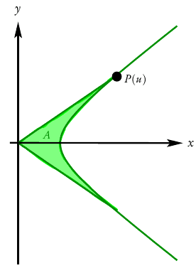

There are no angles! The meaning of the rapidity (here I use ##u## as a parameter) is as in the following picture:
The curve is the unit hyperbola
$$\vec{x}(u)=\begin{pmatrix} x(u) \\ y(u) \end{pmatrix}=\begin{pmatrix} \cosh u \\ \sinh u \end{pmatrix}, \quad u \in \mathbb{R}.$$
The green-shaded area can be parametrized as
$$\vec{x}(\lambda,u')=\lambda \vec{x}(u'), \quad \lambda \in [0,1], \quad u' \in [-u,u].$$
The area then is calculated using the Jacobi determinant
$$J=\partial_{\lambda} x \partial_u y - \partial_{\lambda} y \partial_u x=\lambda (\cosh^2 u'-\sinh^2 u')=\lambda,$$
i.e., the area is
$$A=\int_{-u}^u \mathrm{d} u' \int_0^1 \mathrm{d} \lambda \lambda = u,$$
i.e., ##u## is the area of the "hyperbolic segment" shaded in green.
That's why the inverse functions of the hyperbolic functions are called "area functions", i.e., arcosh, arsinh, artanh.
Likes Kashmir and topsquark

So you defined rapidity ##\theta## as area that lies inside two lines that touch the unit hyperbola . If rapidity is ##\theta## then one of the intersection point of hyperbola with the line is ##(cosh(\theta), sinh(\theta)##.
Now getting back to our figure :
The ##\theta## here is rapidity?

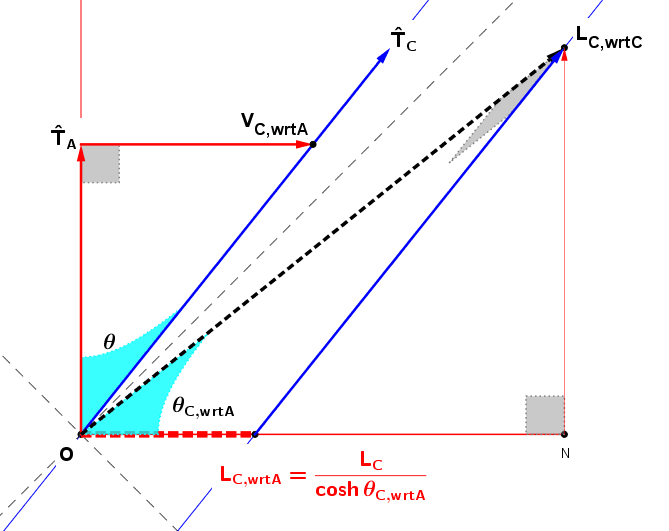

How are you defining ##\theta## on that diagram? For example, if we take ##v \to c##, what is the value of a) the rapidity; b) the ##\theta## shown on your diagram?

I am myself trying to understand that. My book gives me a transformation as:
And gives me a plot :
And then says that ##\theta## is the hyperbolic angle.
I've understood how we define hyperbolic angles or rather call them rapidity as shown by vanhees.
Now I want to link that concept of rapidity with the ##\theta## that's drawn on the book.
That's been explained several times already. Hyperbolic angles are a more abstract mathematical idea. They do not correspond to the internal angles on triangles drawn on a sheet of paper.
To answer my own question, as ##v \to c## the rapidity ##\theta \to \infty##. Whereas, the physical (Euclidean) angle shown on the diagram tends to ##\frac \pi 4##.
That means you have to reconcile the abstractness of Minkowski geometry with the physically Euclidean nature of any diagram you draw.
I would only add that algebra will never deceive you like this!

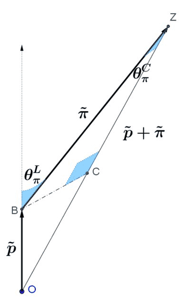

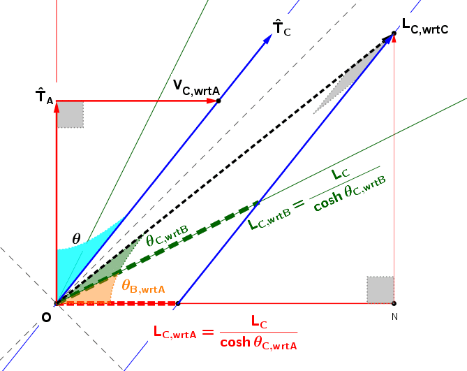

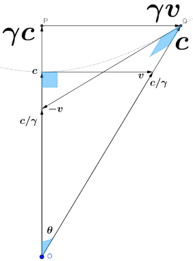

These diagrams may help you appreciate that "rapidity" can be thought of as an "angle",
when used properly. As with any tool, one must learn how to use it and how not-touse it.
Note the use of an arc of the "Minkowski circle"...
so we don't fall into the trap of thinking in terms of Euclidean geometry, as @vanhees71 warns us about.
From https://www.physicsforums.com/threads/velocity-through-spacetime.957038/post-6068213
From my answer to https://physics.stackexchange.com/questions/494698/a-best-definition-of-proper-acceleration
From
https://physics.stackexchange.com/questions/667907/lorentz-transform-moving-length-to-moving-length
In my opinion, since we teach students to use trigonometry to solve free-body diagrams,
we can leverage that experience in trying to teach relativity via hyperbolic-trigonometry
(on the way to possibly having them work with vectors and tensors and use invariant thinking).
There has to be something to show the "geometry" encoded by the tensor-algebra.
As an example of the power of trigonometry, look at my answer to this question:
https://physics.stackexchange.com/q...-out-of-knowledge-kinetic-energy-in-lab-frame
The question asks for a derivation of
##|\vec{p}^{\text{com}}_{\pi}|=\frac{M_{p}\sqrt{T^{L}_{\pi}(T^{L}_{\pi}+2M_{\pi})}}{\sqrt{(M_{p}+M_{\pi})^{2}+2T^{L}_{\pi} M_{p}}}##
and wonders about whether it is dependent on the frame of reference.
My answer gives an answer by interpreting the formula given
as the altitude of a triangle CB in connection with the Law of Sines in Minkowski spacetime.

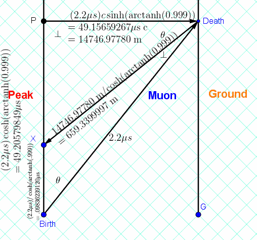

Here is the muon problem solved trigonometrically (however, no angular arcs shown)
from https://physics.stackexchange.com/q...-distance-traveled-and-the-times-it-takes-why

In addition: It is also possible to define the hyperbolic angle as the Lorentzian arc length of the "unit" hyperbola segment.
Source:
https://en.wikipedia.org/wiki/Hyperbolic_angle#Relation_To_The_Minkowski_Line_Element
