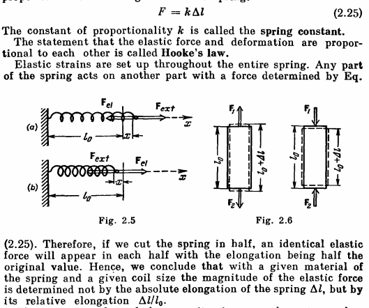

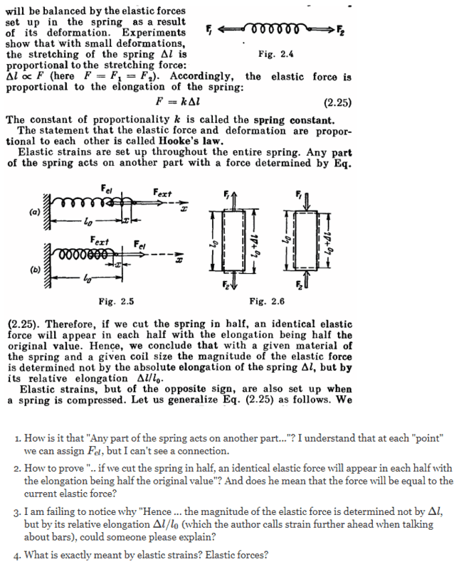

Hello, I need some help on understanding what this book is trying to convey.
How does "any part of the spring acts on another part"? Doesn't (2.25) just give us the "operator force" and, since the spring is at equilibrium, the elastic force? What exactly is strain?
And I am failing to see the "therefore" part and the "Hence" after it, I haven't understood what is before so .. How is it the elastic force that will appear equal to the initial one?
Thank you for your time!

I can see why.
The book has a confusing way to describe a spring.
Since the spring is in equilibrium, there is no acceleration of the spring, and the forces at both ends are equal.
Also, it follows that at any point within the spring, the opposing forces are also equal on either section on either side of that point.
so we could cut the spring in half and the new each half length spring would have the same forces on the ends as before, but with half the total elongation.
Strain, for a spring, is just the amount of deflection ( elongation ) per length.
For the whole spring that would be ( final length - initial length ) / initial length. ( the Δl / L ).

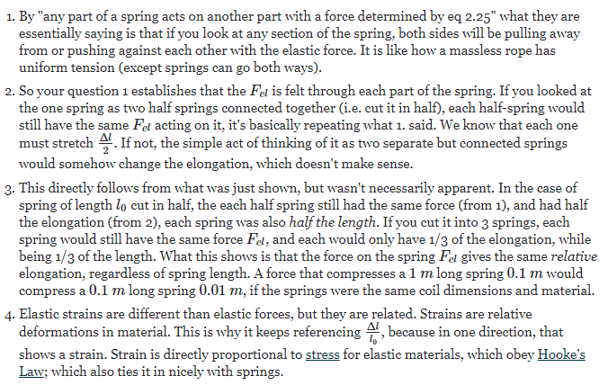

I posted this question but expressed it more thoroughly on physics.stackexchange, I'll share the answer

jedishrfu said:
if you then cut the spring in half ie 5cm segments then you'll need half the force to pull a segment 5cm ie stretching it from 5cm to 10cm.
This is not correct, unless I misunderstand. If you cut a spring in half, the spring constant doubles.
Likes Chestermiller
What the article is saying is that the more correct form of the equation should be $$F=K\frac{\Delta l}{l_o}$$where ##l_o## is the original length and K is a constant (with units of force) that is independent of the original length of the spring. In this equation, the axial strain of the spring is $$\epsilon=\frac{\Delta l}{l_0}$$So, in terms of the usual spring constant, $$k=\frac{K}{l_o}$$This means that the usual spring constant is inversely proportional to the unstretched length of the spring. So if the spring is half as long, its spring constant is twice as large. So, if you have a spring 10 cm long, and you stretch it to 20 centimeters, each half of the spring stretches from 5 cm to 10 cm, and, of course, has the same force as the overall spring.
Likes hutchphd and archaic
