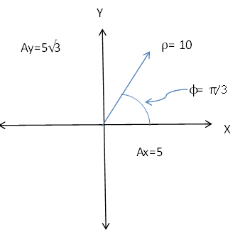

This isn't exactly a "problem" per se , but I need to understand it for a course I'm taking. I'm trying to understand the significance and when to use the vector conversion matrices, or just the identities. I'll use an example that I made up, using rectangular to polar coordinates for simplicity so you can see what I'm not understanding.
I'm fairly comfortable with the following identities to convert polar to rectangular and vice verse :
x = ρ cos Φ
y = ρ sin Φ
ρ = √(x2 + y2)
Φ = tan-1 x/y
but I've difficulty with:
Ax = Aρ cos Φ - AΦ sinΦ
Ay = Aρ sin Φ + AΦ cosΦ
Aρ = Ax cos Φ + Ay sinΦ
AΦ = -Ax sin Φ + Ay cosΦ
In this example: (the lowercase scripts indicate unit vectors.)
Apolar = 10 aρ + π/3 aΦ or
Using:
x = ρ cos Φ, y = ρ sin Φ
with ρ=10, Φ = π/3
Arect = 5 ax + 5√3 ay
which seems correct
but using the matrix and pluging in for Aρ andAΦ
i get:
Ax = 10 cos π/3 - π/3 sin π/3 = 5 - π√3 / 6 ≈ 4
Ay = 10 sin π/3 + π/3 cos π/3 = 5√3 + π/6 ≈ 9.18
So I end up with a vector Arect with components :
Arect = 4 ax + 9.18 ay
So why don't both methods agree.

You are confusing coordinates with vector components. This is natural. In early maths education we are so used to the idea that vectors are arrows from the origin to a point, since this is what we have been taught. This is all good as long as we use cartesian coordinates in euclidean space. As soon we start studying non-euclidean spaces, or even curvilinear coordinates in euclidean space, we need to adapt. We start attaching vectors to every point.
Polar coordinates are an example of this. At every point in the cartesian plane, attach two unit basis vectors. One is along the radial direction, while the other is along the angular direction. If you do that for every point (except for the origin) you get two vector fields, the radial vector field and the angular vector field. You can do something similar with cartesian coordinates, you can attach an ##x## and ##y## basis vector to each point in the cartesian plane. In the cartesian case this is a bit of an overkill, so we don't find it necessary and we discard the idea completaly. However it becomes indispessible for curvilinear coordinates.
Then you take a vector ##A## at a point ##(x,y)##. Since often we want to define ##A## for many points, we can do so by making ##A## a vector field. Anyway, at point ##(x,y)##, suppose we defined ##A## with respect to the cartesian basis. Now do a change of basis (at that point), to the radial and angular unit vectors I described. So you find new components for ##A##. The change of basis is described by a matrix. This matrix depends on the point you have fixed.
If the point is ##(x,y)##, with ##x=\rho\cos\Phi## and ##y=\rho\sin\Phi## (in polar coordinates), at that point, we have the linear transformation of components of ##A## from the polar basis to the cartesian basis, which you already described as

First I will correct my typo.
\begin{align}
&A_x=A_\rho\cos\Phi-A_\Phi\sin\Phi\\
&A_y=A_\rho\sin\Phi+A_\Phi\cos\Phi
\end{align}
I think that now I understand what you were thinking. Let me point out the equations I just wrote apply for an arbitrary vector field ##A##. What you have been doing is choosing a specific ##A## because it 'looks' like the right one.
FrankJ777 said:
So in this example what does it mean that:
Ax = 10 cos π/3 - π/3 sin π/3 = 5 - π√3 / 6 ≈ 4.1
By writting these equations you are assuming you know what ##A## is, i.e. you have just chosen a specific ##A##. You have chosen an ##A## in which ##A_\rho=10## and ##A_\Phi=\pi/3##, because you wanted to make ##A## look like the point where ##A## is evaluated at (remember however that ##A## is a vector field, so it looks different in different points). Even if you fix the point to be ##\rho=10## and ##\Phi=\pi/3## (from now on we will call this point ##p##), ##A## can still be arbitrary.
Now there is nothing wrong with choosing a specific vector field ##A##. Suppose we do insist that ##A_\rho=10## and ##A_\Phi=\pi/3## (at the point ##p##). Then the picture you drew for ##A## is simply wrong. You should draw ##A## as a vector which starts at the point ##p## and whose projection along the radial basis is 10 and whose projection along the angular basis is ##\pi/3##. Another way to think about this is: think of ##p## as the new origin. Then think of two axis, the radial axis is the line which intersects the actual old origin ##0## and the new origin ##p##. The angular axis is the line which is perpendicular to the radial axis, and intersects the radial axis at ##p##. Then, in this new coordinate system attached to ##p##, ##A## will be represented as the vector ##(10,\pi/3)##, so walk ##10## steps from ##p## along the radial axis (in which direction? there are two. Pick the direction that increases your radial coordinate in the usual old system), then walk ##\pi/3## steps along a line parallel to the angular axis (in which direction? there are two. Pick the direction that increases your angular coordinate in the usual old system). I hope you can draw this.
Once you have this picture, the calculation for ##A_x## and ##A_y## simply means that now you an xy basis attached to ##p##. So you must draw once again two axis, which intersect at ##p##, one parallel to the original ##x## axis, one parallel to the original ##y## axis. Now instead of projecting the vector ##A## (the same vector that you already drew) into the radial and angular axis, you project into the new ##x## and ##y## axis, and the numbers you will find for the coordinates are the numbers you computed ##4.1## and ##9.18##.
You can put the vector ##A##, all four axis and four projections into the same picture. Then the picture becomes self-explanatory. Note that you can draw the same picture for an arbitrary point ##p## and an arbitrary vector field ##A##. This is in fact the standard way to represent vector fields in a plane, as searching 'vector field' in google images will certainly show. I hope I made myself clear.
