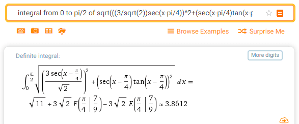

I'm trying that in Wolfram (this is just for fun and not actual homework anyway) but I seem to be doing something wrong. Where is my mistake?
The derivative of [itex]A\sec\theta[/itex] is [itex]A\sec\theta \tan\theta[/itex].
