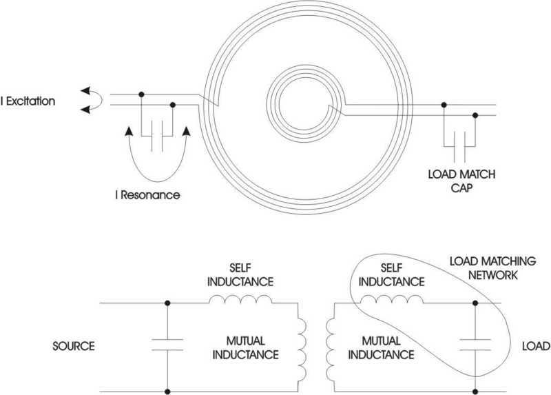

From what I understand, the main coil is connected directly to the signal generator via a twisted pair transmission line (crocodile clips).
For max power transfer, you need to do some impedance matching - the impedance of the signal generator, to the transmission line, and then to the coil loop where the energy is to be dumped, otherwise some of the signal is reflected from the coil back to the generator and thus wasting power.Chances are that the pick up coil is highly untuned in your setup, the breadboard adds capacitance, and you have it going between the crocodile clips. Try putting the capacitor banks together with the coil, and add a small trimmer cap to tune with screw driver. Make sure that the tank is resonating at the desired frequency by checking it using a sweep generator or a network analyzer if there is one lying around somewhere.Also, air core coils don't have a high Q, increase the Q by adding a ferromagnetic core.

In the photo, I see you have a single led and the impedance matching capacitors. The problem I see is that your transmitting and receiving coils are both AC devices and an led is a DC device. The led will present a load only to one half of the voltage swing, which may lead to saturation of your coil, I would try placing another led in anti-parallel with the other led.

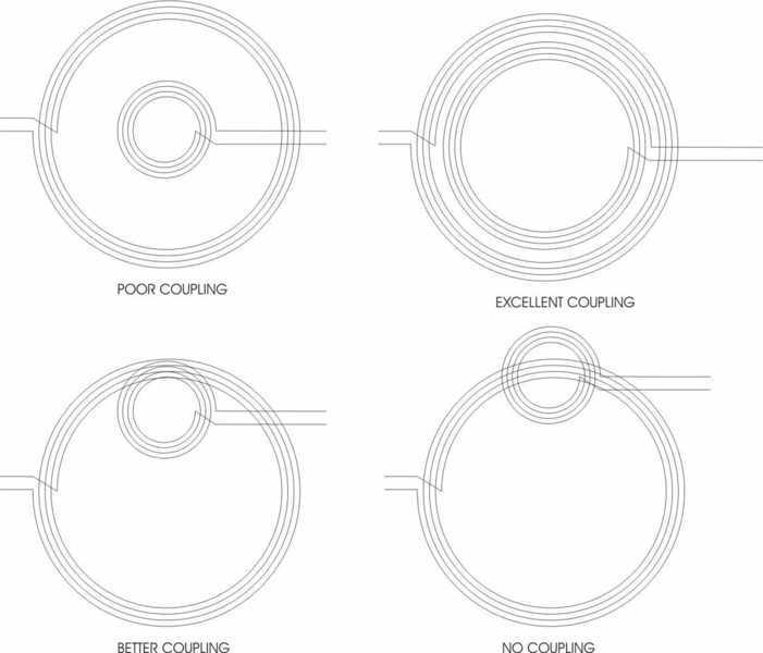

You will get best coupling between the coils if they are of similar diameter. About a foot would be OK.

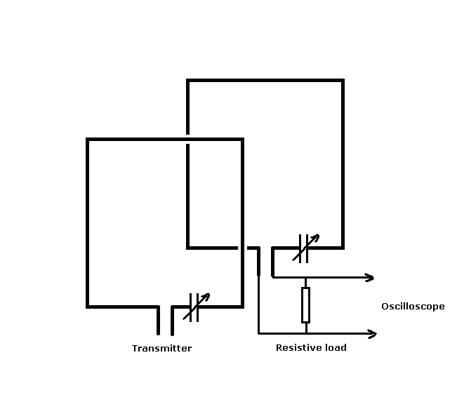

Providing an update after one semester of work, and seeing if anyone can find a solution to our problem.
Using equations for resonance and inductance, we have managed to light our LED up to a meter away using a big loop antenna transmitter and a spiral antenna receiver. We have also designed some external circuitry (i.e. amplifier, signal generator, etc.).
Our goal now is to get some accurate measurements as far as efficiency. We measured the power supplied by our transmitter and theoretically verified it. The calculation verified our measurement.
However, when we tried to measure the receiver power, we ended up getting more power out than we are putting in! We've tried measuring this various ways, using test loads (various resistors). Unfortunately, we don't know an easy way we can calculate this theoretically, because of factors such as mutual inductance.
One guess we have is that the Earth ground on our oscilloscope is messing up the measurement? We are fairly confident about our transmitter measurement, but we are pretty sure our receiver calculation is incorrect.

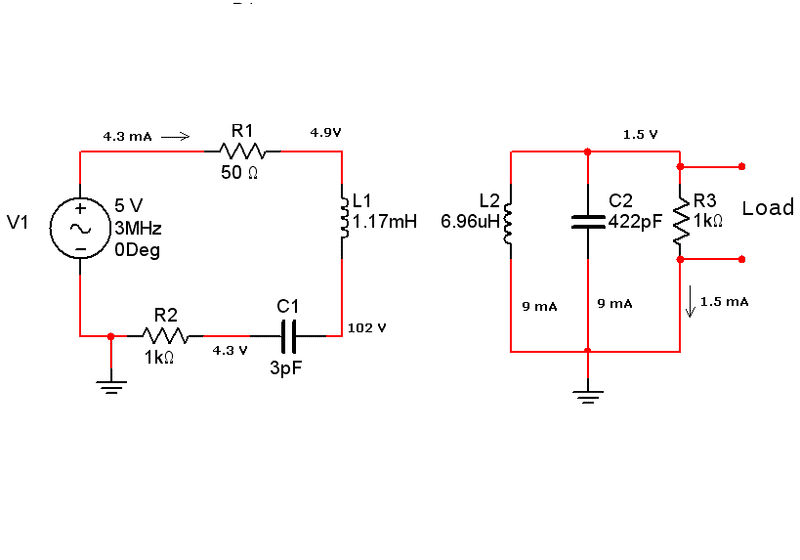

R1 is the 50 ohm output impedance of our signal generator. We are using a 1k test load (R2), and using the Vrms value over that load to then calculate the current in our transmitter. We use that current and the voltage supplied to get the power supplied by our transmitter. We have verified this measurement theoretically.
On our receiver, we are measuring the Vrms over our 1k load (indicated), squaring it, and dividing the resistance to get the power at the receiver.
Doing these measurements, there is more power over the receiver than the transmitter is supplying, and we are trying to solve this problem.
We kind of get the feeling that grounding isn't causing the measurement to be thrown off, that we are simply are missing something. Is there a radiative power equation we need to be using?

The power you are transmitting has nothing to do with R2. That is just in series with the transmitting coil.
You would have to measure the current in R2 but the voltage across L1. This will be mostly reactive but a very small percentage of the volt-amps fed to L1 would be radiated.
This is because the coil is too small to be an effective antenna at 3 MHz.
I'm not even sure you could estimate the radiated power like this.
To get more power radiated you could remove (or reduce) R2 as it is just limiting the power radiated.
Also that 3 pF probably needs to be a variable C as stray capacitance would add up to more than that.
The circuit may work better without it.
L1 is very nearly self resonant so you may have to remove some turns to get a better tuning action.
How did you measure L1? Do you know its dimensions and number of turns?

I realize the power being transmitted has nothing to do with R2; R2 is ONLY USED to measure current. We're not actually measuring the power transmitted, we're measuring the power SUPPLIED by the signal generator. We get the voltage by measuring the voltage across L1, C2, and R2... which is the same voltage being supplied by the signal generator (or alternatively you could take a BNC cable and hook it up to an oscilloscope to see what the supply voltage is).
Regardless, the power supplied by the signal generator should be greater than the power of the receiver load.
I still have not gotten any helpful suggestions regarding why we are failing to measure the power on the receiver correctly.
Isn't apparent power in = apparent power out? Or am I mistaken?
We are simply comparing Vrms*Irms on the transmitter and Vrms*Irms on the receiver.

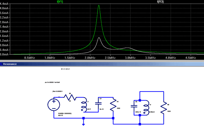

I used LTSpice to do a simulation of this setup.
I had to make a big assumption that the two coils had a coupling coefficient of 10 %. This is probably on the high side but I will rerun it if you feel it might be different.
https://www.physicsforums.com/attachment.php?attachmentid=23169&d=1263908551
According to this, the signal generator produces 5 volts at 4.3 mA and the receiver tuned circuit produces 1.5 volts across 1000 ohms producing a current of 1.5 mA.
This means that the maximum power in is 21.5 mW and the power out is 2.25 mW.
This would be about 10 % efficiency.

In viewing your photograph, md5fungi. The axis of pickup coil is not aligned with the axis of the transmitting coil. You do realized that the two should be coaxial, right?
Didn't quite realize that, but we're using a larger spiral antenna for our receiving coil now. From how we hold the spiral receiver relative to the big loop transmitter, it seems to behave how you'd expect a magnetic field to behave.

I used the computer simulation program LTSpiceIV. So, no equations, just some voltages and currents for you to compare with if you like.
You said you wanted to find out why you are getting over 100 % efficiency, so comparing these voltages might give you a way of doing that.
I described it in the same way as you did, comparing the received signal level with that out of the signal generator.
However, 18.5 mW of the 21.5 mW out of the generator are actually used up in the 1 K resistor, R2. This leaves 3 mW into the transmit coil producing 2.25 mW in the receive resistor, which is pretty good efficiency
The simulation program gave a double hump in the response. The main peak was at 2.2 MHz (from the transmit coil) with a smaller one at 3 MHz (from the receive coil).
The coupling coefficient is the ratio of the actual mutual inductance present, to the maximum mutual inductance possible between the inductors involved.
I will leave you to look it up if you are interested, but it is a useful way of describing how closely two tuned circuits are coupled together. This is useful because it affects the frequency response and also the power transfer.

I worked on this problem about 12 years ago for a trans-dermal power supply (medical implant). On the primary side, the problem is one of getting sufficient flux linkage in the area of the pick up coil - N, I, and geometry.
For even a few 10's of mW at an inch away, the current in the primary side gets very high - on the order of an amp. To reduce losses on the primary side, the current in the primary recirculated through a parallel resonant tank circuit. Silver mica caps proved to have low loss for this application.
The secondary side was not tuned to resonate with the primary. Instead, it's parallel capacitor served to work with it's leakage inductance to obtain maximum power transfer. Since the coupling between primary and secondary coils would change with the application, the optimum value for the secondary capacitor would vary. Our pragmatic fix for this was to optimize the value for the poorest reasonable coupling - thus you get an improvement in transmission range at a cost in maximum power transfer.
I've attached a couple of drawings to communicate the basic idea and to give some idea as to why the power transfer varies with different orientations of the secondary.
Have fun,
Mike

vk6kro, I spiced the circuit using LTSpice and also Multisim. The results were satisfactory. I still, however, cannot measure the power correctly.
We've done all sorts of things to measure the power. We're calculating Real Power by using Vmax values and using the equation P = 1/2(Re(VI*)). Besides this, we've tried apparent power and RMS calculations.
We simplified the calculation by building a voltage doubler/rectifier on the output and measuring that as a DC value. No matter what we do, we measure more power on our receiver coil. We also made sure we are picking up no stray signals.
We really need a solution to this problem; we're not sure what's happening, we've tried multiple oscilloscopes/probes and approaches to the problem.
  • #34
If you can be sure your resistor is 1000 ohms, you would measure the peak to peak value of the RF signal (that is the total amplitude of the waveform) divide by 2.828 to get RMS and then using V*V / R, calculate the power.
However I very much doubt that your resistor would be 1000 ohms at 3 MHz. I have an antenna analyser which can measure such things and I have seen resistors give very peculiar values at radio frequencies.
The best I have seen are surface mount resistors. At such low power, just a single 1000 ohm resistor would probably be OK. You have two 1 K resistors and I suggest you check or change them both.
Some metal film resistors seem OK. Others are really bad. I can't think of a way of testing them unless you have access to an antenna analyser.
Have you tried having two oscilloscopes, one on the transmitter and one on the receiver?
If you had an oscilloscope on the transmitter and then moved it to the receiver, this could remove a load from the transmitter which might then transmit more power than when you were doing the measurement.
A simple RF probe for an oscilloscope is to use a half wave voltage doubler
http://dl.dropbox.com/u/4222062/RF%20probe.PNG
This gives a reading close to the peak to peak value of the input signal. The capacitors I have shown as 22 pF should be as small (in pF) as possible to still get a good reading.

Wow, these are both very good points.
It's a good point that the resistors may behave differently at high frequencies, and possibly have a significant self-inductance.
I think we have access to antenna analyzers that will help us make some impedance measurements at HF.
It's also a good point that our oscilloscope may be loading our circuit, and that our circuit may deliver more power when it's not hooked up. I think we tried using two oscilloscopes simultaneously before, but then again, I'm not sure we were measuring power correctly.
Thanks for the help again, vk6kro, this is probably the most helpful response I've gotten so far.
