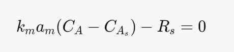

The heterogeneous reaction is represent by mass transfer to the solid phase.
Where Dr-radial diffusion coefficient
Dz- Axial diffusion coefficient [m^2/s]
vz- superficial fluid velocity [m/s]
km- mass transfer coefficient [m/s]
am- particle surface area per unit bed volume [m^-1]
k-rate constant [s^-1]

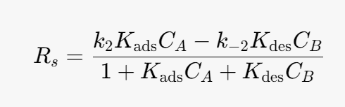

Rs- heterogeneous rate of reaction (LHHW)
1)A+S⇌A-S (chemisorption of A)
2)A-S⇌B-S (Surface reaction)
3) B-S⇌B+S (Desorption of B)
2) is the rate determining reaction and 1) and 3) are assumed to be in equilibrium.
There is a single type of site and there is competitive adsorption between A and B.

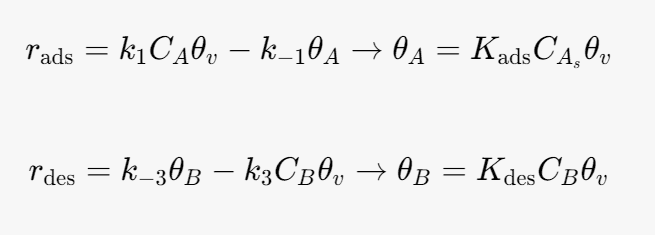

The rate of adsorption is given by
At equilibrium the net rate of adsorption and desorption are 0. Therefore the surface coverage by A and B are given by.

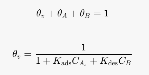

where θv is the fraction of vacant sites.
Site balance:

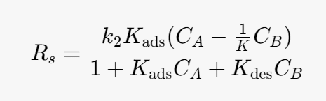

Substitute into the rate determining step (rate equation):

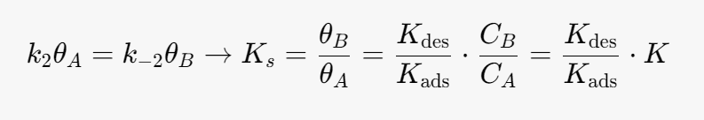

We can simplify the above equation using the equilibrium constant for the heterogeneous reaction. At equilibrium the surface reaction is equal to 0.
Kads- [m^3/mol]
Kdes- [m^3/mol]
k2 -[mol/(m^3*s)]

Will Rs be given by the following formula?View attachment 336940
