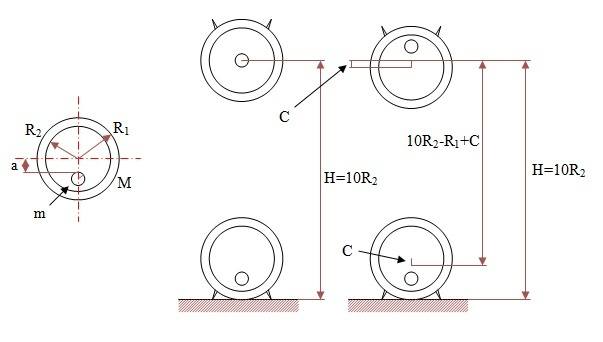

A spaceship has a shape of a hollow tube with outer radius R1, internal radius R2 and mass "M". it rotates at angular velocity ω0. it has 4 short, mass less legs.
In it there is a bar of radius "r" and mass "m". it can be moved instantly to any distance "a" from the center.
The ship starts to fall from height H=10R2 with the legs up and the inner bar at the center. the computer immediately moves the bar to a certain distance "a" upwards, so when the ship touches the ground the legs are at the bottom. it made half a rotation.
Find a formula for "a" so that the ship will land with legs down.

There is a diagram at the end of the OP. The rod is parallel to the spin axis, both being horizontal. The idea is to control the rate of spin so that when the tube hits the ground it has done one half rotation. Control is exercised by moving the rod nearer to or further from the spin axis.

I think 'a' is supposed to be the distance the rod's centre is displaced.
Yes, I should have looked at the diagram; didn't.

If i take 'a' to be the distance to the center of the rod:
$$I=\frac{1}{2}M\left(R_1^2+R_2^2\right)+\frac{1}{2}mr^2+ma^2$$
The center of mass when the bar is off the center is at distance C:
$$ma=C(M+m)\rightarrow C=\frac{m}{M+m}$$
Free fall between the centers of mass at the top and bottom positions:
$$h=\frac{1}{2}gt^2\rightarrow t^2=\frac{2}{g}\left(10R_2-R_1+\frac{a}{M+m}\right)$$
The ship makes half a turn, i.e. π[rad]. The new angular velocity:
$$\omega_1=\frac{\pi}{t}=\frac{\pi}{\sqrt{\frac{2}{g}\left(10R_2-R_1+\frac{a}{M+m}\right)}}$$
Moment of inertia round the new center of mass:
$$I_1=\frac{1}{2}\left[M\left(R_2^2+R_1^2\right)+mr^2\right]+M\left(\frac{a}{M+m}\right)^2+m\left(a-\frac{a}{M+m}\right)$$
Conservation of angular momentum:
$$I_c\omega_0=I_1\omega_1\rightarrow \frac{1}{2}\left[M\left(R_1^2+R_2^2\right)+mr^2\right]\cdot \omega_0=I_1\omega_1$$
And i have to isolate 'a' from here.

Several places where you have ##\frac m{M+m}## or ##\frac a{M+m}## that should be ##\frac {ma}{M+m}##. Check the dimensionalities throughout.
##I_1=\frac{1}{2}\left[M\left(R_2^2+R_1^2\right)+mr^2\right]+M\left(\frac{a}{M+m}\right)^2+m\left(a-\frac{a}{M+m}\right)##
I don't know how you get those last two terms. They're both dimensionally wrong.
Remember, if you have a moment of inertia about a point other than the mass centre you need to apply the parallel axis theorem in reverse to get it about the mass centre. Anyway, I get:
##I_1=\frac{1}{2}\left[M\left(R_2^2+R_1^2\right)+mr^2\right]+\frac{Mma^2}{M+m}##

My suspicion is that you were expected to discard the occurrence of a on the left of that last equation on grounds of its being insignificant, but I don't see any basis for saying that it is. Indeed, it could be more significant than the a on the right.
Arguably "a formula for a" does not have to mean isolating it as "a = ...". The ship's computer should be capable of finding a from the equation you arrived at.

The snag is that, as Kaspis showed, the time of descent is also a function of a. This is why it appears on the left hand side of K's final equation. As I wrote, I was expecting to be able to argue that this could be ignored, but I see no basis for doing so. Indeed, it may be the dominant effect of a.
It would be eliminated if the question were to state that the rod returned to its original position at the last moment.
I am pretty certain the intent, justifiable or not, was to ignore this complication.
