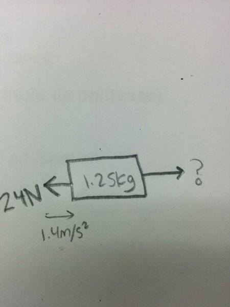

I'm just confused with the weight of the rope... Cause isn't it possible that there is gravity beeing exerted onto it... And wouldn't that have an impact on the result
Haven't you ever been in a tug of war contest?
The weight of the rope is irrelevant to the force of the pull being applied by the people on each end of the rope.
No. Neglect the weight. That's in the vertical direction, and we're doing a force balance in the horizontal direction. So...
By the way, your free body diagram is correct.
Chet
