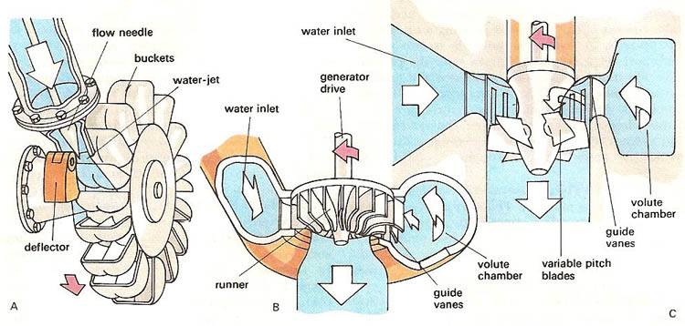

I am working on a design for a water powered drive shaft. The water source would be from a 2.5 inch diameter hose, at approx 75-100 psi. The goal would be to get 55-115 RPM from the shaft and max torque in the smallest possible handheld device. That being said, it seems my best options for driving such a shaft would be a turbine of one of three designs: crossflow vs turgo vs pelton. What do you think is the best drive to get these results? A pitot-tube pressure of at least 344 kilopascals (kPa) (75 pounds per square inch (psi)), and a flow rate of at least 300 liters per minute (lpm) (80 gallons per minute (gpm)); So we are talking about .3m^3/m @ about 75 psi. So approx 0.005 m^3/s

Welcome to PF. That is a very powerful water stream you are talking about.
The pictures below are from https://en.wikipedia.org/wiki/Water_turbine
First, I recommend just talking about power and power efficiency rather than RPM and torque. It is much simpler and more to the point.

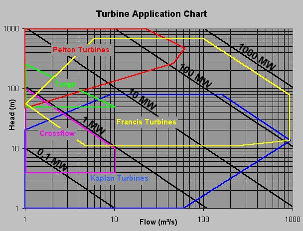

Second, the key parameter is the flow rate m3/s. You gave hose diameter and pressure. Do you know the flow rate? Once you know the flow rate and pressure, you can look it up on a curve such as this to see which kind of turbine is most applicable.

A pitot-tube pressure of at least 344 kilopascals (kPa) (50 pounds per square inch (psi)), and a flow rate of at least 300 liters per minute (lpm) (80 gallons per minute (gpm)); So we are talking about .3m^3/m @ about 50 psi. So approx 0.005 m^3/s. Looks like 50 psi is about 36 meters of head.
That sounds modest. You said 2.5 inch hose and 100 PSI (I presume 100 at the nozzle.) Fire equipment catalogs say up to 700 gpm for similar numbers.
Let's say 0.04 m3/sec and 70 m head. In any case, that's 2 decades off-scale on that diagram. Too bad.
