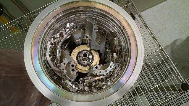

A scraping noise is never good. A slight increase in vibration at one or more points is normally because of a mechanical resonance in the rotor, that's normal during a spin-up. I would suspect it was dumped hard a few times, warped a few blades to almost touching (touching slightly during max vibration) and is slightly unbalanced causing stress on the blades at high speed. It might blowup in 30 seconds pumping a large gas load or it might last years with a light load and minimal stress.
If it does fail at full speed the results can be expensive.
A clean destruction.

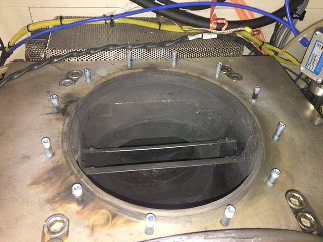

A dirty one on an Ion Implanter at full beam power.

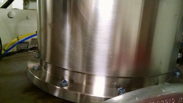

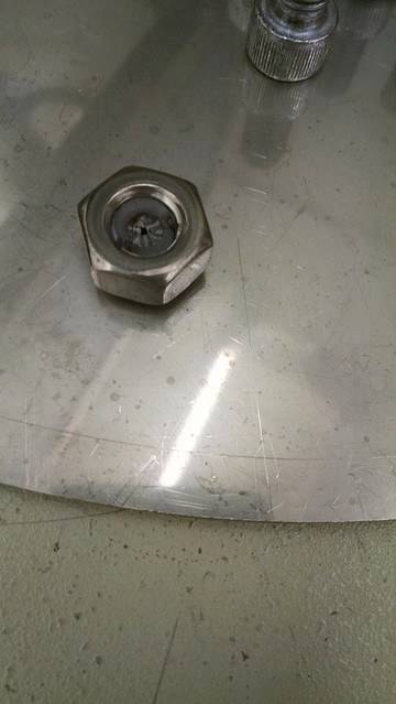

Every bolt nut sheared off as the turbo lifted from the chamber at e-5 Torr vacuum.
Found a few that hit the top of the enclosure.
The studs are designed to break at X pull. This reduces the possibility of the chamber wall being warped
by a turbo failure.

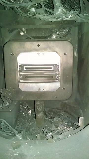

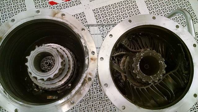

Ion source and beamline pumps
Turbo parts inside ion source chamber. Ion beam manipulator.

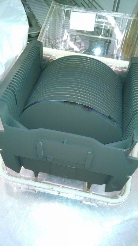

It dusted all the product in the machine with graphite combustion/destruction products
246159
The shiny edge on the top wafer is what they all should look like. The once white label on top of the wafer holder is what every inch of the normally clean processing end chamber looked like after the implosion shock-wave traveled inside the machine from the source failure.
