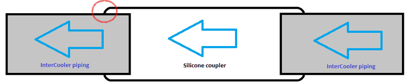

To be a little more specific let's take the drawing below. Air is flowing from right to left in a straight section of intercooler piping joined by a silicone coupler held on by band clamps. Let's say the band clamp on the left is a little loose and is causing a leak at the red circle. Would static air leak more, less, or the same as air moving at a high velocity directly at the leak? This might be another "it depends" scenario, and that's fine but hopefully this will narrow the scope of my question.

I'd say its possible it may leak more, but it could just as easily leak less if you looked at the other connection in your diagram. Its not a simple question you are asking. There are a number of variables that can affect this, including flow rate, piping wall thickness, pipe diameter, shape of the end of the pipe (rounded, tapered, straight cut), etc. And even then, mathematically solving this isn't trivial. I would suspect most engineers would think about the effects qualitatively. Use computer simulations to model the effects. Then actually test it to confirm. I doubt you are going to find such a specific answer to validate your position. And frankly, being more specific only validates that particular scenario, where the answer to your original question truly is, it depends.
I don't really have a position I'm trying to validate at this point. I just thought of that example off the top of my head because it's a common cause of boost leaks and I was trying to be specific. But I understand your point about too many variables. A better example would've been a straight pipe with a small hole in it. But from Mech_Engineer's response, in that example it sounds like the leak will leak the same amount of air whether the air is static or moving with a lot of velocity over the point of the leak.
Actually the leak rate would be reduced as the velocity increased assuming the hole were perfectly perpendicular to the flow because the static pressure at the hole would be reduced just as it is in a pitot type air speed indicator for aircraft with one tube entry aimed directly at the flow to identify the total pressure and the other perpendicular to measure static pressure. At the same time there is the effect of flow impingement against the down stream edge of the hole that complicates the issue.
With regard to your diagram, a leak at the downstream edge of the flex hose connection should be greater than one at the upstream connection assuming the leak is the same size at both points or the tubing has no clamps and is very flexible so that the increased static pressure at the downstream impingement point would stretch the hose more than at the upstream connection.with the flow away from the connection edge.
Of course this is all theoretical and the difference relative to the total leakage at both points could be insignificant.
