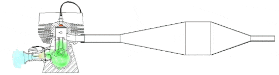

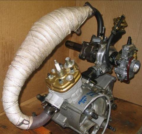

Hi everyone, online I ve seen some images about 2 stroke carbureted turbo
(motorcycle derivation engine).
Now.. In the past in this forum some members spoke about turbocharging 2 stroke but not in sufficient detail.
The intake and the exhaust are open at the same time and there are no valves like a 4 stroke.
But if you search online you can find carbureted 2stroke turbo sled or the Am6 turbo.
The question is:
Is really possible turbocharge a 2 stroke carburated(NOT EFI)petrol engine and make more horsepower with these engine's config. ??
If yes how it can work??
I attached 2 images. Look at the Am6 (small bike engine) its a reed motor draw through.
And the other, the sled seems a piston port motor blow through.
Hope to see interesting answers ad learn something about.

A couple of thoughts just looking at the pictures (if the engines pictured actually run):
-As I'd expect, there seems to be a need for some more complicated cross section of piping between the cylinder and the turbo, but in some, it appears to look a lot like a typical motorcycle muffler. The appearance of what looks like a motorcycle muffler makes me think parts were re-used for economy. I don't know that this is the result of a calculated design as much as something that was put together trial-and-error.
-The outboard motor is more interesting. The diaphragm valve on the turbo outlet looks to be an exhaust bleed. Without knowing the internal plumbing, it is difficult to tell exactly what they are doing but I suspect the turbo has artificially high back pressure that can be changed by bleeding exhaust or reducing the turbo outlet pressure resistance in some way, or it may have unusually low back pressure and the valve can increase it.

Yes it's what I mean. The mistery is that thing seems work! But if we look the 2 stroke working process seems impossible. The return wave in the exhaust can put back the fresh charge expelled from the cylinder but if this fresh charge is boosted also how can it work? The gif picture is exactly the same engine principle of what I said. You can see carb Reeds and the ports open at the same time. Imagine to put a turbo at the outlet of the pipe.
Anyone can explain how a turbo can work on this?
The turbo has enough inertia so it keeps spinning/compressing between exhaust pulses. Also, whatever volume between the turbo and the carb will remain pressurized.

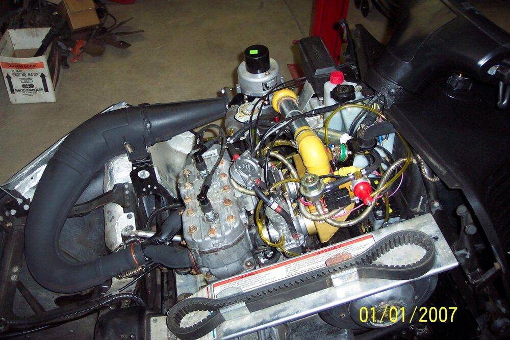

Here's a shot of the assembled Merc with the Aerodyne turbo.
Likes Luth

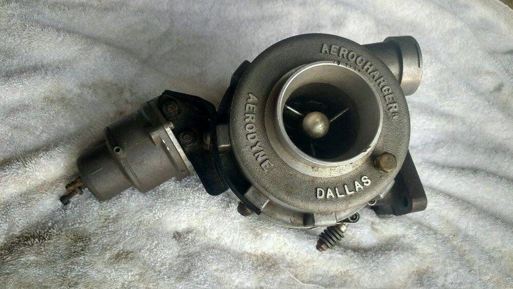

Here's the turbo
Likes Luth

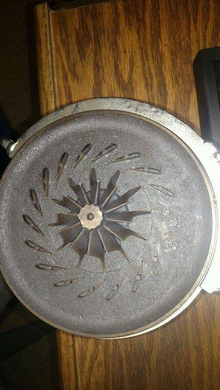

Here is the unique way the Aerodyne controls boost, from the outside, the ring of vanes can be changed to direct exhaust gases towards the outside of the driven turbine to increase boost.
Likes Luth
