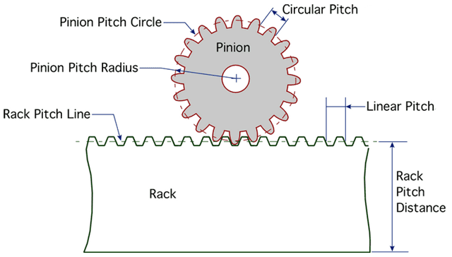

Here's some basic mechanical engineering question for you guys.
How can one turn a press of a button (or pulling) into a rotation?
My goal is to be able to have the button in any orientation and position and still be able to rotate a dial 360 degrees when fully pressed/pulled by 5mm. I suspect this can be made with few springs and strings.
I think what happens inside mechanical dial indicators and hook weight scales is the clue, sadly any disassembly video or article I saw doesn't go into detail or talks about electric ones which lack the most important part I think.I could go on to explain the actual device I'm trying to build but it involves computer vision and more components so would take a while to explain and complicate stuff.
Welcome to the PF. :smile:
Are you familiar with Rack and Pinion mechanisms? You may need to add some gearing to get the full rotation with a modest push/pull motion...
http://cogmatic.com/wp-content/uploads/2011/02/rack-and-pinion-specification-diagram.png

So in the animation, the dial should have rotated 360° when the button was pressed at the end? You might be able to accomplish that with pneumatics or hydraulics, or even still the rack and pinion mechanism. The lower end of the rack would be attached to the outside of the spherical bearing that encloses the ball at the top of the switch end.
Sounds very interesting but not sure I follow. Can you rephrase this please?
Sure. In your animation, the rotation of the switch into different positions should not rotate the dial. Have the upper part of the switch be a spherical ball encased in a spherical shell that is the outer surface of the smooth bearing (ball in socket). The bottom end of the sphere is open enough to allow the switch to be tilted to each side as you show in the animation.
A vertical rack is attached to the top of the spherical surface, and engages a pinion gear near the center of the dial (maybe including an extra gear to step-up the linear motion to a full dial rotation). When the switch is pressed upward, that displaces the spherical shell and rack upward linearly, which rotates the pinion gear. The rack is spring loaded downward, so when the upward pressure on the switch is released, the switch and sphere+rack return to the full downward position.
