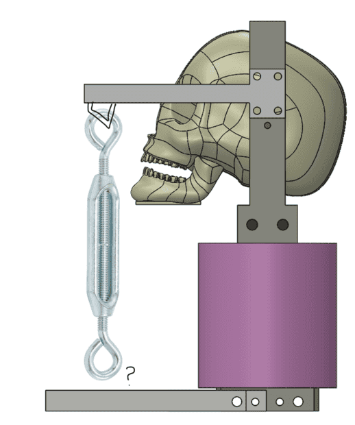

I'm looking to build an adjustable mechanism for a concussion model rig. The premise is that it must be able to tilt the skull, and release the tilt at the moment of impact to not affect how the head whiplashes.

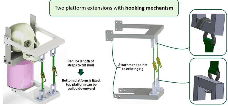

As you can see in Picture 1, I originally designed two platforms to fit onto the model, connected to one another by a mini ratchet strap.

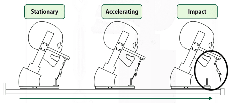

The idea as shown in Picture 2, is that the model could pre-set to an angle, where it accelerates down a track using a pneumatic actuator and the force of the sudden stop at the end of the track would blow the bottom hooks off their anchor point. This would release all the tension in the straps, meaning the skull could whiplash freely mimicking a concussion.
However, I was suggested to use mini turnbuckles (open end full length ~ 250 mm, can be any end fittings) as opposed to ratchet straps, and to also change the mechanism of releasing the bottom attachment due to likely low reliability of release.
So this leaves me with a question: What is the best way of manipulating the bottom fitting of a turnbuckle to tilt the skull, but release at impact?
Any suggestions would be much appreciated. 1701357260572.png1701357426935.png1701357464170.png
I would consider an over-centre latch, loaded with a mass, or with a trigger, so it will release on impact.
Such latches are made to hold the tail-gates of trailers, and the sides of small trucks. They are also used for work holding during machining operations. In order to get a quick, clean release, you will need to adjust them to the edge of stability.
You might design your own OC latch for the specific application. It can be as simple as two hooked or stepped plates, with a separate small plate that locks them until triggered.

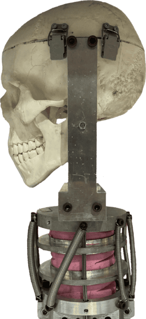

Welcome, @Robbwal199 !
I see a problem with the mass and freedom to move after impact of those turnbuckles.
Also, the pink elastic cylinder is going to turn some kinetic energy into elastic potential energy, situation that does not exist in the natural neck.
From personal experience with motorcycle crashes, the muscles of the neck are meaningless when trying to restrain a head and a helmet during even a moderate impact.
For ideas, look up “Quick release inertial mechanism”.

Thanks Lnewqban,
There is certainly some issues with the neck design, but unfortunately the model is already created so my focus is solely on implementing this tilt mechanism. The resistance for the first maybe 15 degrees of tilting is low, but gets increasingly more difficult after this.
Re mass and freedom to move of the turnbuckles, what do you exactly mean by this? Is it that the mass of the released turnbuckle would significantly affect head movement?
Yes.
Those may even damage the skull when loose right after impact, I believe.
I would move the releasing mechanism to the top end, or even aft, in such a way that it is not connected to the tilting model during impact in any way.
Likes berkeman and Robbwal199

Robbwal199 said:
are the fixtures you're referencing the tilting platforms or the skull?
I was thinking of the platform, that which everything is mounted on, the lower end of both the turnbuckles and the neck.
If that is too damaging to the hardware, perhaps you could mount the whole thing on a larger-dimensioned solid block (or sheet) of wood. That way the wood block could take the surface damage of hitting a brick wall.
Re-reading your early posts, pointed out another concerning point. Any inertial latch release will by definition release only after the deceleration starts!
A release mechanism wiil have to be mechanically triggered by contacting the stop at the moment the platform contacts it.

How about release lever(s) (posts) on your fixture that are horizontal and stick out a little from the leading edge of the fixture. They could contact the barrier that stops the travel just before the fixture hits the stop. Timing could be varied by adjusting their length (how far they stick out from the fixture).
Cheers,
Tom

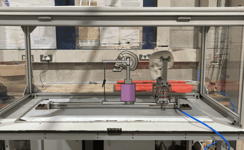

Hi Tom,
My apologies for not providing more detail about the track/stopping mechanism (see picture attached). The hardstop is initiated by the "stroke length" of the actuator being reached. Your suggestion did make me think about placing something past the hardstop (just left of end of track in picture) that could remove eg: a latch holding the eye of a turnbuckle in place.
