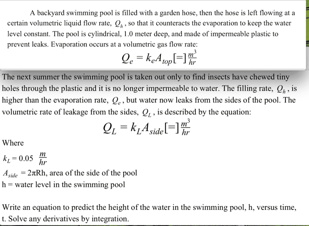

I have posted a picture of the HW problem below.
potentially could use:
Accumulation=Input-Output+Generation-Consumption
So I am a bit confused on how to get started. So far my thought process is we have water flowing in and water evaporating from the pool. The part that I think we are interested in is the leakage. The leakage has the rate it is flowing out per unit time. I will call it change in volume, or dV, per unit time, or dt.
My initial thought is:
dV/dt=QL from above equation and integrate both sides, but I don't have the variable "t" on the right hand side of the equation. If someone could walk me through a logical way of turning this word problem into a derivative that would be great.
Something else I would like to clarify: Are we trying to turn this into a differential equation? The course I am in uses DE's and I honestly don't know.
Thanks so much!
cookiemnstr510510 said:
$${dV\over dt}=Q_L$$
Is a genuine differential equation. The fact that the righthand side does not depend on ##t## makes it a fairly easy one, but a DE nonetheless. However, you forget two other ##Q##.
And in
Accumulation=Input-Output-Generation+Consumption
I suspect a sign error: if someone swallows water, that does not increase he holdup of the pool ... :rolleyes: and the sign for 'generation' likewise seems erroneous.

So I have spent some time looking at the problem and I now have a few more questions.
When setting up my D.E. I have learned that what I am doing with this problem is first: setting up boundaries. My boundaries are the swimming pool. I then want to know how the mass of the water is changing over a certain time period. I then choose my time period to be very close to zero so I can use differential calculus.
Let me show you with some work:
I will keep everything in units of mass. We are given flow rates of things (volumes), I will denote the density of liquid water ρl and vapor water ρv
ΔVρl=(Qhρl-Qeρv-Qlρl)Δt
I now let Δt-->0
dVρl/dt=Qhρl-Qeρv-Qlρl
now I think we have a separable D.E. so I can separate and integrate both sides.
I asked around and got some info from classmates that I am now trying to make sense of. They are saying that I should turn Vρl to the equivalent equation of πr2l. And my bounds of integration would be h=0 to h=? since we want an equation in terms of height.
Is the reason we need to turn our volume into πr2h so that we have the variable h, which is what the question is asking?
I was just going to leave it in terms of V...but haven't tried that yet.

Kudos for mentioning ##\rho_v## -- I had completely missed it and assumed ##Q_e## in m3/h water o:)
So far you have $$\rho_L\, dV/dt= \rho_L\, Q_h - \rho_v \, Q_e - \rho_L \,Q_L$$ with ##Q_h## and ##Q_e## independent of ##V##, but ##Q_L ## not. Either you do ##V = \pi R^2 h## and ##Q_L = k_L\,2\pi Rh## to write an equation in terms of ##h##, or you leave ##V## and take ##Q_L = k_L\,2\pi R \displaystyle {V\over \pi R^2}\ ##.
Since the exercise asks for ##h(t)## the former is a good choice.
So is starting with ##h(0) = 0##.
And the integration goes from 0 to ##t## to get ##h## as a function of ##t##.
You consider ##Q_h## as input (but to get the thing filled before the summer is over, it should be bigger than the ##Q_h## after filling last year :smile: ) .
A bit strange that the exercise gives numerical values for a few of the variables, but not enough for a complete calculation (e.g. ##Q_e##).

I get $$A_{top}\frac{dh}{dt}=Q_h-Q_e-k_L(2\pi R)h$$This is a first order linear ODE in h.
There is the small matter of ##\ {\rho_v\over\rho_L} \ ## in front of ##Q_e##, but apart from that I agree (as in post #9)
To me, it is obvious that ##Q_e## is supposed to represent the rate at which liquid water is evaporating. In my judgment, for a problem presented to a student at this level, this is the only thing it could mean.

So would ##\frac{\rho_g}{\rho_l} = \frac{m}{V_g} \frac{V_l}{m} = \frac{0.0001}{57.8} = 1.73 * 10^{-6}##??
For a final differential equation of (the h by the Q is a subscript)
##\frac{dh}{dt} = \frac{Q_h}{\pi R^2} - \left( 1.73 * 10^{-6} \right) k_e - k_l \left(\frac{2}{R} \right)h##which can then be solved using the method found here
http://tutorial.math.lamar.edu/Classes/DE/Linear.aspx
##\frac{dy}{dt}+ p\left( t \right)y = g\left( t \right) ##
##y\left(t \right) = \frac{\int \mu \left( t \right) g\left( t \right) dt + c}{\mu \left(t \right)}##
where
## \mu \left( t \right) = e^{\int p\left(t\right) dt}##
