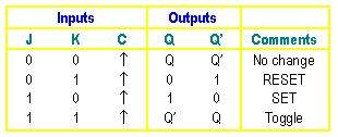

I'm asked to turn JFKK to DFF. I am always puzzled by such problems. I decided to take it step by step and first draw the truth charts and black-boxes for each:
http://img204.imageshack.us/img204/6189/jkffkk.jpg
I can see that in order to turn JKFF truth table to DFF, in line to I need it to be 00. But even if I attach NOT gate to K, then the first line no longer matches DFF truth table. I started looking at logic gates, but it appears no matter which change I make in one line I can't get all my lines to correspond. Can I get any hints?
Another question I have is, am I only allowed to attach logic gates to J or K in such exercises, or can I do crazier things like attaching J to K?
If you attach not gate to K (from J input) only 2nd and 3rd lines from JKFF truth table will be possible states. Thus your DFF will work as expected.
BTW, the 1st line of JKFF is wrong. It will be 0 0 Q Q'
The 1st and 2nd lines of DFF will be 0 0 Q Q' and 0 1 Q Q'

I was told to do this by my teacher:
http://img141.imageshack.us/img141/8427/jkok.jpg
But after getting home I try to look into the logic of it. Does it mean J and K always get the same signal?
I was trying to put it in a truth table but wasn't sure how
Yes.
If J and K are always the same, which possibilities do you have for the combination of J and K?
00 and 11
so 00 = No change
11 = Flips values
Same as DFF

the value of clk doesn't generally get included in a truth table, because the operation of a clocked flip flop is not dependent on its value, rather on its edge. a truth table for a clocked device is generally supposed to be interpreted as "what happens when you get a triggering edge on clk"
those two images are easier to work from, and you can see that the D output matches the jk output for two specific cases, D = 1 matches J = 1,K = 0, and D = 0 matches J = 0, K = 1.
with that information, can you see the combinational logic circuit required to take D as input, and J, K as output?
edit: just noticed that clk is included in the t-tables i posted, despite me saying that they shouldn't be there. all that entry is showing is that this is only valid for a rising edge on clk, and since they all have it, the conclusion is that without a rising edge nothing happens...
Oh, yes! I think I finally get the picture here:

I find it quite strange that your lecturer told you the wrong answer, be sure to ask them for clarification!
ps, do you recognise any other type of flip flop in the truth table for the drawing
it is a valid conversion, just not for the D-type.
Yes! T Flip-flop!
