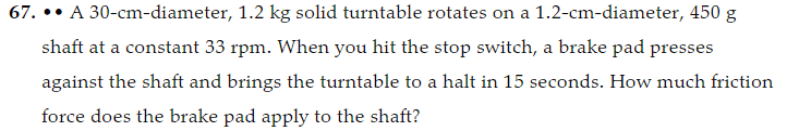

ωf = ωo = αt
∑τ = Iα
[/B]
1) Find the acceleration
ωf = ωo + αt
fo) / t = α = -0.231 rad/sec
2) Find ∑τ
∑τ =Iα
I assumed that the only torque acting on the turntable was the torque due to friction
τfriction = (1/2)MR2(-0.231) = -.00312 N*m
Looks OK so far. How do you get the friction force from the torque?
Likes BrainMan
I didn't see a justification for ignoring the moment of inertia of the shaft (I'm assuming that the M and R above are for the disk).
Likes BrainMan
So if I factor in the moment of inertia of the shaft I get the ∑τ = Itotalα
=> [(1/2)MR2 + (1/2)mr2 ](-0.231) = -0.00312 N*m
=> Ffriction = ∑τ / (R+r) = -0.020 N
The correct answer should be 0.52 N so I'm not sure how I'm so far off.
Why use R + r ? Note that the brake pads are applied to the shaft.
Likes BrainMan
Okay if I use r instead of R + r I get the right answer. Thanks!
