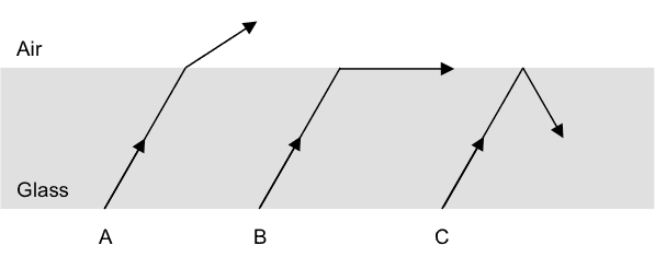

Transition from glass to air, make a sketch of the light ray.
All three sketches shown are correct. However, as a grader of this I would have a hard time deciding whether a student who sketched C is completely clueless about refraction or understands it so well that he/she drew the case of internal reflection. The ambiguity rests with the phrasing of the question: the word "transition" implies that the ray is moving (transiting) towards the interface from the glass side but is not strong enough to denote that the ray actually exits the glass.

Actually B is not possible, despite it often being an exam answer.
Hint: it is not reversible!

kuruman said:
Example 2
I think that everyone just draws A and that this works out somewhat fine. But yes, we know that more cases exist and that also makes the answer ambiguous.
