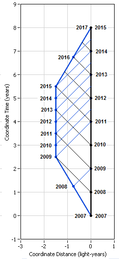

In summary, the document states that if the twins experience the same two acceleration profiles but with different times between them then the twins experience a difference in aging.

Doesn't sound right. If both are accelerating, but with different (vector) functions, the results will be different.
Acceleration is only invoked to break the symmetry between the twins. In this case, it still breaks the symmetry since their acceleration profiles are different.
Not as I read it. The twins experience exactly the same accelerations, just at different times. Actually, the first twin has a long gap between his two accelerations while the second twin has no gap.
But I think it would have been easier to see this if extra time were inserted between both gaps. Then we would see the two twins starting out inertially and colocated (at rest with respect to each other), one of them accelerates (the document says decelerates, but it's the same thing) and then the two twins have a relative separation speed between them. After some time, the second twin accelerates in exactly the same way as the first one did, bringing them to rest with respect to each other but with a constant separation between them. Next the second twin accelerates again in the same direction, possibly with the same acceleration as before but this is not necessary. This causes the twins to have a relative closing speed between them that continually reduces their separation. Just before they make contact, the first twin accelerates in exactly the same way as the other twin's second acceleration, bringing them once more into mutual inertial rest and colocation but with different aging accumulated during their time of separation.
I think this is a brilliant variant of the Twin Paradox that shows that acceleration has nothing to do with the difference in aging and it also can't be used to determine which twin is younger, in other words, acceleration cannot be "invoked to break the symmetry between the twins". It also shows that it is not necessary for the twins to return to the same location that they started out in or even that they need to be at rest in the same frame they started out in. But it has the same "paradoxical" issue that while separated, in each twin's inertial rest frame(s), the other twin's time is dilated.
I just don't understand the U-frame/U-time explanation but like all SR scenarios, the standard explanations using inertial frames work just fine. Did you make the document, phyti? Do you understand the explanation?

That is asymmetric. What is the symmetry operation which maps one twin's acceleration profile to the other?
According to SR the laws of physics are invariant under spatial rotations, spatial and temporal translations, and boosts. If you make an acceleration and time measurement profile that is symmetric under some combination of those symmetry operations then the twins will have the same elapsed age. Otherwise there is an asymmetry and they do not have the same age.

The document looked to me like it was showing the two acceleration intervals of the first twin concatenated together to form the acceleration profile of the second twin. I broke it apart into two acceleration profiles and inserted a time gap between them (and added the same time gap to the first twin) to make this more obvious in my explanation.
So both twins experience the same two acceleration profiles but with different times between them. It's not the acceleration profiles alone that explain the difference in aging but rather we have to include the time interval between them to get the full story. I just thought this was a brilliant way to counter the argument that "it's the twin that accelerates that ends up younger" and the erroneous conclusion that it is only the acceleration that creates the time difference between them.

phyti, too much focus is given to the acceleration. It's the path lengths through space-time that should be compared, regardless of whether one or both are accelerating and when the accelerations occur.

An "acceleration profile" is the entire history of acceleration between the two meetings. Different timings means different profiles.

The deceleration profiles are purposely made equivalent, the two for A connected together equal the one for B, in duration and curvature and tangent (speed) vectors. If you employed integration methods for the two complete curved profiles, they are equal. In the traditional simple case, B changes course 3 times, departs, reverses, and returns. He has 3 speed changes to 0 for A, thus his accumulated time is shorter, so the argument goes. Are you going to invoke asymmetry in this case in favor of A because he has 2 changes to 1 for B?
By eliminating the acceleration/deceleration issues, the focus is on the inertial portions, and specificaly on time lost as it relates to speed. The example also emphasizes the time lost is permanent, since there is no speed by which a clock can gain time.

This is my own work. After the continuous rehashing of the 'twin thing', I thought there should be a simpler way, possibly without math, to demonstrate physically why there is differential aging. The U-frame represents a universal time standard, and the red portions represent what's missing after subtracting the dilated time for A and B.
You have a good understanding of the post, thank you.

You are missing the point of the twin paradox.
The question is not: "How can I explain the age difference geometrically in one inertial frame?"
The question is : "Why can't I use the same explanation in both twin's rest frames to get the opposite result?"
The answer to the question is : "Difference in proper acceleration profiles"

That is a rotation by 180º, which is a symmetry of SR. We can conclude that they are the same age.

Is your point for the scenario in this thread that it doesn't apply to the Twin Paradox because neither twin is inertial?
So the only kind of answer that you will accept is one that shows an inertial explanation for the inertial twin and simply asserts that no such explanation applies to the non-inertial twin (simply because he is non-inertial)?
So when the questioner correctly points out that in the inertial twin's rest frame, there is a constant Time Dilation for the non-inertial twin (assuming instant turn-around), but the rest frame for the non-inertial twin is non-inertial and so it is an incorrect comparison and we simply stop right there. We just call foul?
  • #33
I agree with you, that's why the post. The accumulated time on a clock depends on the path. Obviously there must be a change in speed to assume a new direction. Ignoring the separation and reunion, we could easily have the A clock do a reversal, then both paths woud be 'bent'. Which acceleration/deceleration (there is a difference) counts?
Examining the expression for time dilation, the only factor is v/c. The space-time drawing with ct and x axes represents what?...speed, i.e. object motion vt vs. light motion ct, or v/c. The velocity change can be approximated with a series of inertial segments, without any significant loss of accuracy.
  • #34
A.T. said:
Yes. I'm not against geometrical explanations. But if you do it only in the inertial frame, you are not really addressing the issue.
I don't understand this comment. Geometrical explanations are frame independent, they are not done in any frame. If an explanation uses any frame then it isn't a geometrical explanation.
However, I agree with what I think is your main point that the answer must be in terms of some asymmetry.
  • #35
harrylin said:
Acceleration is indeed necessary to break the symmetry in SR (thus ignoring gravitational time dilation); it was the purpose of the "twin" example to clarify that fact. It should be stressed that what matters for the SR calculation is the velocity profiles.
I agree. Geometrically the acceleration is the "bend" in the worldline. That bend breaks the symmetry but by itself it doesn't add or subtract any length to the worldline.
