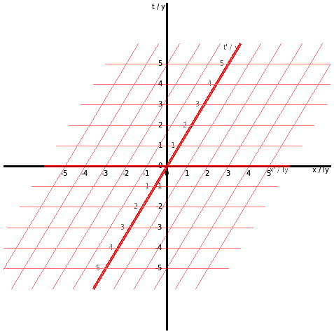

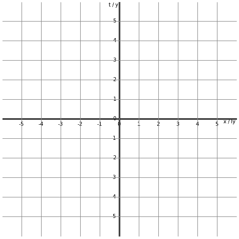

It's perhaps worth explaining what the Lorentz transforms really mean. Simply draw a displacement-time graph (by convention in relativity, time goes up the page, not across). Since we interpret space and time as a single 4d-manifold, we now interpret this as a map of a "slice" through spacetime. As with any map, we can draw a coordinate grid:
So far, so boring. But if you look at the Lorentz transforms (without adding any ##x=ct## nonsense) then you find that the ##t'=0## and ##x'=0## lines are straight lines through the origin with slope ##1/v## and ##v## respectively. That means we can draw the primed coordinate grid on this diagram (picking ##v=0.6c## in this case):

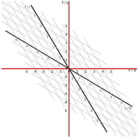

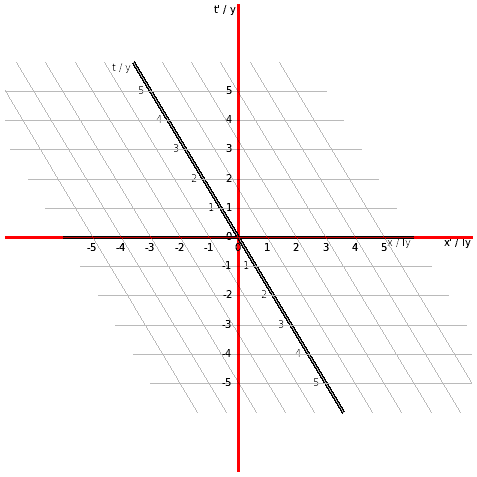

I've removed the black coordinate grid for clarity. Note that the red lines are orthogonal to each other in the Minkowski sense. To see this, consider a vector along the ##t'## axis expressed in terms of the unprimed coordinate system, ##(v\Delta t,\Delta t)^T##, and a vector along the ##x'## axis, ##(\Delta x,v\Delta x)^T## (note that I've picked units where ##c=1## and suppressed the ##c##s - you can put them back in by dimensional analysis if you want). The Minkowski sense of orthogonal is that the product of the x components minus the product of the t components is zero, and sure enough: ##(v\Delta t)(\Delta x)−(\Delta t)(v\Delta x)=0##. The axes only appear non-orthogonal on the diagram because the page obeys Euclidean geometry and we cannot represent a Minkowski geometry plane exactly accurately.
Since the primed axes are orthogonal we can draw the same diagram using that frame, making the black unprimed frame appear skewed (and suppressing the red grid this time):

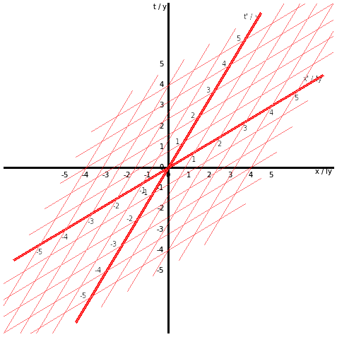

All that the Lorentz transforms do is this: pick a point on the chart (representing an event in spacetime) and read off its coordinates using the black grid and then the red grid. Apply the Lorentz transforms (with ##v=0.6c## in the case I've drawn) to the ##(x,t)## values you read from the black grid and you will get the values you read from the red grid.
And now you can see what is: it's the inverse gradient of the time axis of the primed coordinate system in the unprimed coordinates system, and is also the speed the unprimed coordinate system assigns to objects at rest in the primed frame.
The whole of the content of special relativity is working out the implications of the "natural" coordinates transforming like the above instead of the Galilean transforms, which skew the coordinate grids in different way. The equivalent to the second and third images, if Newtonian physics were anywhere near correct at ##0.6c## would be these two:
Note that in these last two diagrams the coordinate grids share a definition of "space at one time" (the spatial axes of both frames are parallel) and a clock tick rate (the time coordinate labels are at the same heights). Neither of these apply in relativity.
