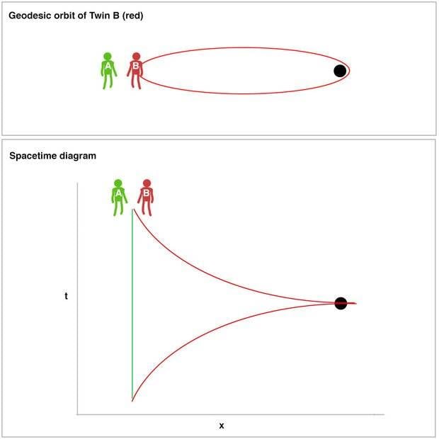

What is the result of the Twin Paradox if the round trip of one twin is entirely on a geodesic?
~ Shower Thoughts ~
Twin A is in a spaceship, Twin B is in a spaceship. Both in 'deep space'.
B follows a highly elliptical geodesic which goes around a planet (or black hole) with strong gravity, very far away.
When they meet again, who is younger and why?
I genuinely don't know what this answer will be.
( In an ideal case A stays in Flat Minkowski Spacetime during B's trip. However, A will need to accelerate a little bit away from the distant planet to maintain position. Does this small bit of acceleration may make the difference in the end..? dunno)
I'm going through Eigenchris's youtube videos, and he has an amazing explanation of the Twin Paradox, essentially saying the solution is "The reversed triangle inequality (assuming timeline vectors). In which geodesics have the longest proper time, and non-geodesics have shorter proper time."
That made sense to me in SR terms, so I thought I'd see if I could convolute it with some GR curvature. Since Twin B follows geodesics, and A must slightly accelerate... is A younger? Or is B effected by gravitational time dilation as it goes around the planet and thus B is younger?
Very curious. Thoughts?
At first I thought you were referring to a different case, where e.g. A is hovering at a distance from the sun and B is on circular orbit meeting A every orbit. In this case, A will elapse more time between meeting even though B is geodesic and A is not. The seeming 'paradox' is resolved by noting there is a different geodesic between the meeting points that elapses more time than A: the geodesic that moves radially outward from A at an initial velocity such that it 'falls back' in exactly the time it takes B to orbit. This is the global maximum geodesic between these points.
Your case is different. If you mean for both to be geodesics, with A being very far a way in 'asymptotically flat' spacetime, while B does an eccentric orbit, then A would elapse the maximal time.
In general, with gravity, there may be two or more geodesics between a pair of events. One of them will be the global maximal elapsed time. The others will elapse less time than many non-geodesic world lines.
This is great. Thank you.
How does one determine the maximal geodesic?
I'm not to keen on the hard math, so if you have a geometric example, I'd love to see it.
I don't know of any general rule. In the case of Schwarzschild metric, you can just 'read' from the metric that a circular orbit will elapse less time than a non-inertial stationary observer at the same radius. Just a little harder is to demonstrate that the pure radial geodesic (out and back) is the global maximum between two events at the same radius and angular coordinates, separated by some time. However, even in this very simple metric, other cases of multiple geodesics (e.g. elliptical orbits of different shapes and positions that have a pair of event intersections) just have to be calculated. All you know is that the maximal geodesic will be a maximal proper time among all possible world lines.

It's so A can be in almost flat spacetime.
Thanks for all the wonderful responses to this question.
It sounds like, no matter if the geodesic is hyperbolic, highly elliptical, or circular, Twin A will elapse more time.
One of the things that I wanted to get out of this question was if 'local acceleration' matters. Such that Twin B, being on a geodesic, should never feel like they are accelerating. Twin B is "falling" the whole time during the round trip.
@PAllen point to different geodesics between two events is something that I had not really considered before, and is extremely interesting. If there is no easy way to find the maximal geodesic, is there a way to find the minimal geodesic?
Could we say that the minimal geodesic between two points is the one which comes closest to a body (or bodies) of mass?
You just have to find all geodesics and then see which is the longest and which is the shortest. I don’t know of any shortcuts
