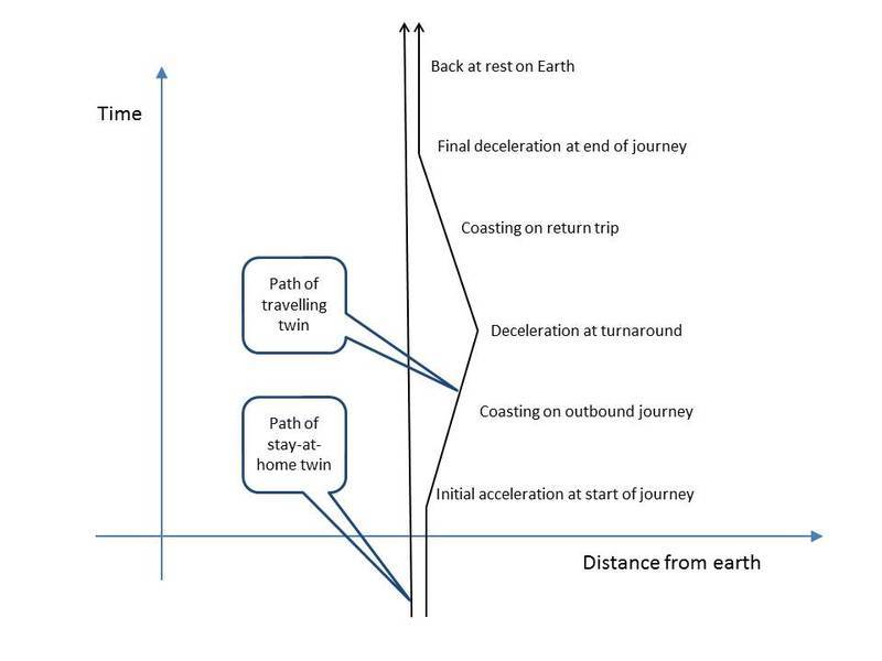

robinpike said:
The problem with Relativity's explanation for the Twin paradox, is that, once back on earth, for the traveling twin's clock to have a lesser time than the stay at home twin's clock, it can be deduced that the rate of time on the traveling twin's clock must have slowed down at some point during the journey.
No, that's not true. Not in any objective sense.
Here's an analogy. Suppose you have a system of roads, and every road has markers on it every 100 meters. You have two roads that meet at a point, diverge, and then come back together at a second point. You can compare the number of markers along the two different roads between the first meeting and the second meeting. You might find that one road has a greater number of markers between the two points than the other road. Does that mean that the road with the greater number of markers must have its markers closer together, or that the road with the small number of markers must have its markers farther apart? No, it's just that the distance between two points depends on the path taken. The number of markers is an accurate measure of these two distances.
In SR, the analogy of "number of markers along a road" is "number of ticks of a clock along a spacetime path". Two spacetime paths meet at some point, diverge, and then come back together later. The number of clock ticks between the two points is different for the two different paths. Does this mean that one clock's ticks come closer together, or that the other clock's ticks come farther apart? No, it's just that the proper time between two points depends on the spacetime path taken.

  • #74
TrickyDicky said:
I'm just separating the "formal plane" of the paradox solution in SR versus the real universe where unlike in flat Minkowski space, there are no pure inertial frames but they are nevertheless used in idealized situations where its use is irrelevant to the problem at hand.
When there is no actual inertial reference, I at least wouldn't know how to compute the time dilation that accumulates between the twins.
I still don't understand what you're talking about. The reason that there are no inertial frames in the real universe is because of gravity. In the absence of gravity, Earth would be at rest in an inertial frame. But you seem to want to say that Earth is not inertial, and ALSO you want to ignore gravity.
There is no way to accurately compute elapsed times on clocks near the Earth without taking gravity into account. The elapsed time on a clock as it travels between events A and B is given by:
[itex]\tau = \int_A^B \sqrt{g_{ij} dx^i dx^j}[/itex]
where [itex]g_{ij}[/itex] is the metric tensor coefficients.
For the Earth, a good approximation to [itex]\tau[/itex] for slow velocities is given by:
[itex]\tau = \int_A^B (1 - \dfrac{G M}{c^2 r} - \dfrac{1}{2} \dfrac{v^2}{c^2}) dt[/itex]

  • #78
TrickyDicky said:
[..]I was stressing you need at least one inertial reference. [..]
Sorry that I understood what you said, and not what you meant. :bugeye:
So yes, SR refers to inertial frames, just like classical physics. And you now understand my explanation of how to calculate it accounting for the non-inertial Earth observer. Good. :smile:
[EDIT:] However, why then do you state in-between:
:rolleyes: That was what I thought to have explained you in post #62, and it appeared that you understood it...
But perhaps you mean that if we lack some necessary data (such as specifications that can be converted to an inertial frame), then we can't compute the outcome? That's very true!
  • #79
