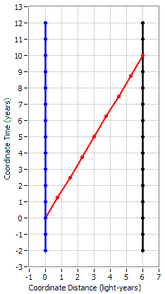

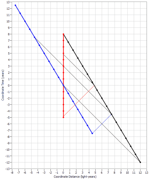

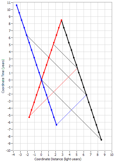

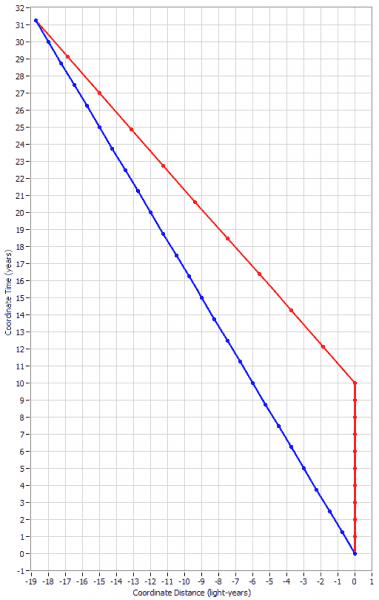

What you are saying is true for the beginning of the scenario but not for the entire scenario. Let's suppose that Stella travels away from Terrence at 60%c for 8 years then turns around and takes another 8 years to get back. Here is a spacetime diagram showing this where Stella's worldline is red and Terrence's is blue and the dots mark off 1-year increments of Proper Time for both of them:
Note that after 5 years of Coordinate Time, Terrence has aged 5 years (because this is Terrence's rest frame) while Stella has aged only 4 years.

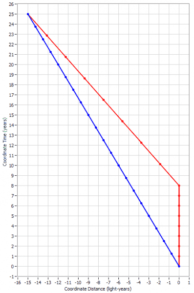

Now we transform to the rest frame of Stella during the first part of the scenario:
Note how after 5 years of Coordinate Time, Stella has aged 5 years while Terrence has aged only 4 years just as you pointed out. However, when we look at the entire scenario from either spacetime diagram, Terrence ages 20 years while Stella ages 16 years.
Does this clear up what you are missing?
ghwellsjr said:
Note how after 5 years of Coordinate Time, Stella has aged 5 years while Terrance has aged only 4 years just as you pointed out. However, when we look at the entire scenario from either spacetime diagram, Terrance ages 20 years while Stella ages 16 years.
ghwellsjr - Thank you for this answer. In fact if you see before the turn around (the first part of the journey) from Stella's rest frame, Stella has aged 8 years while Terrence has aged only 6+ years of proper time.
The turn around is the main reason. In this case, if you see, after the turn around, the reference frame used by your diagram here is no more the "turned around" Stella's reference frame but the original reference frame of stella during the first part of the journey which is a reasonable and right approach, as you don't want to change your frame of reference midway just because Stella jumped unto a different reference frame for the second part of the journey. If you actually plot the reverse journey with the "turned around" Stella's reference frame as rest frame and then paste it with the first part of the journey (though not correct to do it as you need to stick when plotting space time diagram with one reference frame) it would be an opposite of the space diagram as seen from the Terrence's reference frame (but lengths would be different as the longest side will be 16 instead of 20 but nevertheless the bents would be switched resulting in a smaller triangle). But ofcourse I realize I followed an illegal approach as I changed the reference frame midway because I was sticking to Stella. But unfortunately she changed her reference frame by turning around. That was what I think I was missing - thank you for the insight and clarity!

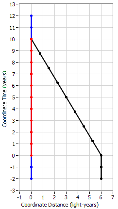

But how did you calculate when using Stella's rest reference frame in the onward journey that she is at rest for 8 years? If we assume Stella is at rest then the space station (at the turn around point) has to travel to her. In that case, I am assuming the space station is traveling at 0.6 c towards Stella who is at rest. The distance between Stella and space station in 6 light years. So shouldn't space station take 10 years to reach Stella according to Stella? Why 8 years? Shouldnt the bend happen after 10 years of rest (travelling in time)?
I think in this diagram, I feel there should be a correction made. The red line should go from (0,0) to (0,10) and not to (0,8) and the bend for the red line happens at (0,10) and then the line goes to (-15,25). At coordinate time 10 yrs, Terrence location will be -6 in x-axis which is correct as at the turn around point Terrence and Stella are separated by 6 light years. And also Terrence would have also spent proper time of 8 years (check graph) and so 2 years slower than Stella as we expected. So it is not 8/6.5 but 10/8 between Stella and Terrence at the turn around point as suggested by the above figure, an exact reverse of the world lines as seen from Terrance side (atleast for the first part of the journey) like I initially pointed out in my first post. But after that for the second part of the journey lines slope in such a manner we get back to original answer of 16 years for Stella and 20 years for Terrence at (-15,25) which tallies well with the answer we expected at the end of the journey. No confusion there if we don't change frames midway following Stella.
Considering this to be the case, then I can go back to my original thought experiment which I believe is now valid if the above reasoning is valid.

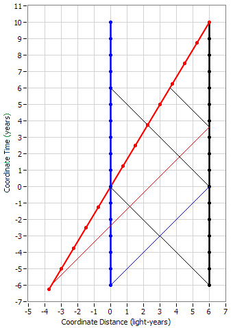

We have two events: Stella leaves earth; and Stella arrives at space station.
In a frame at which Terence is at rest, the (t,x) coordinates of these two events are (0,0) and (10,6): Terence set his watch to zero at the time of Stella's departure and says that Stella arrives at the station 6 light-years away at the same time that Terence's watch reads 10 years. Clearly Terence ages ten years while this is going on, but we can double-check by calculating the proper time between the events "Stella's departure" and "Terence celebrates his tenth birthday and says to himself 'wow - she should be arriving at the space station right about now'". That event has coordinates, in the frame in which Terence is at rest, of (10,0) and the proper time comes out to be ##\sqrt{(10-0)^2-(0-0)^2}=10##.
Now we use the Lorentz transforms to see what the coordinates of these two events are using the frame in which Stella is at rest on the outbound leg. Her departure event is still (0,0), but Stella coordinates for the second event are (8,0) - and we get this not by using the time dilation formula, but by using the Lorentz transforms which relate Terence's x,t coordinates to Stella's and vice versa.
You can calculate how much Stella aged during her trip by using either Terence's coordinates (##\sqrt{(10-0)^2-(6-0)^2}=8## or using Stella's coordinates ##\sqrt{(8-0)^2-(0-0)^2}=8## and we get the same eight years as the answer. It would be a good exercise to transform Terence's coordinates (10,0) for the event of his tenth birthday party to Stella's coordinates - note that although Stella arrives at the station at the same time as the party starts according to Terence, the party and Stella's arrival at the station are not(!) simultaneous according to Stella - and verify that Stella also calculates that Terence has aged ten years between the departure event and the party event.
No, the diagram is right. The event "Stella arrives at the station" happens at time 10 and position 6 in a frame in which Terence is at rest - but the diagram is showing coordinates in which Stella is at rest, and in those coordinates the arrival event happens at time 8 and position 0. An arbitrary point on the Terence diagram (the one in which Terence's worldline moves straight up the page) with coordinate x and t is the same point as the point on the Stella diagram with coordinates x' and t' given by the Lorentz transformations:
##x'=\gamma(x-vt)##
##t'=\gamma(t-vx)##
Try it, and you'll find that Terence's (10,6) is Stella's (8,0).

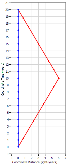

Stella travels from Earth to a space station which is 6 Light years away and then turns around and comes back. In the first part of the journey symmetry is not broken and so both Stella and Terrence's frames are equivalent. Both think the other person's time is slower. As per Stella she reaches the space station in 10 years, Terrence thinks she reaches the space station in 8 years.
Terence is the one who finds that outbound leg is ten years. This is just basic distance=speed*time and time=distance/speed: Stella has to cover six light years while moving at .6c relative to Terence so he divides the distance by the speed (6/.6) and gets ten years. As far as Stella is concerned, however, she is at rest while Terence and the station are moving backwards at .6c. Because they are moving relative to her, the distance between them is length-contracted to 24/5=4.8 light years. So she has a space station that is 4.8 light years away, racing towards her at .6c even as the Earth and Terence disappear in her rear view mirror at the same speed. She calculates 4.8/.6 to get 8 years for the station to reach her.

The diagram is correct. You are missing the relativity of simultaneity. You need to use the full Lorentz transform, not just bits and pieces.
Or you can take Mentz114's suggestion and forget coordinates and frames altogether and focus on the invariant quantities like proper time.

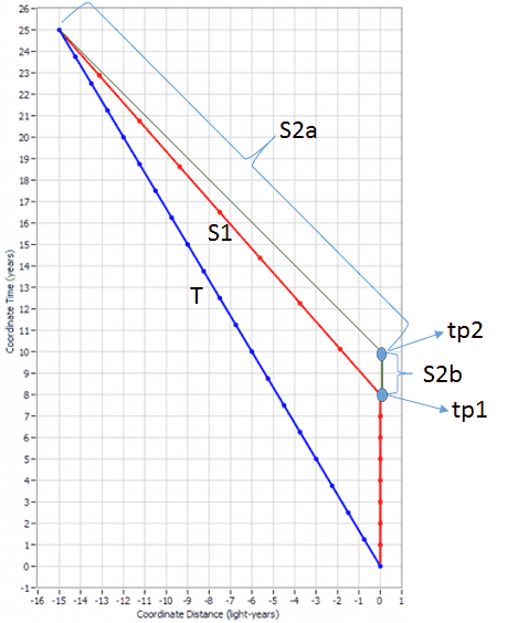

Here below I list both paths in the diagram - the path I suggested and the path originally which was suggested by ghwellsjr. This diagram is drawn with the reference of Frame 2 (the frame which travels at 0.6c away from earth). Stella travels with Frame 2 in the first half of the journey and then the second half she turns around and travels in direction opposite to Frame 2's movement with the same speed (0.6c). Frame 1 is the one assuming the rest frame as earth.
I have been contending in the above ST diagram, the path taken by Stella is S2 and not S1 as originally proposed by ghwellsjr. The key point of contention is in Frame 2, whether the turn around point happens at tp1 (0,8) or tp2 (0,10)? I still hold Lorentz contraction is not for space but for moving objects. In Michelson Morley experiment or above cart video, the experimental set up itself contracted to reduce the length traveled by light to ensure you don't need to increase the speed of light for the light to do the round-trip in the given time. There distance in space outside the experiment didnt contract which I believe if I am not wrong was what was suggested above by Nugatory in reducing the space to 4.8 light years instead of 10 which I am not still able to understand convincingly though I get the calculation from the formulaes.

But having said all that, I see there is a way to prove that my contention about the path S2 is wrong. The slope of the line S2a is 45 degrees which means Stella is traveling in Frame 2 at light speed which is not true. The relative velocity based on the formula of relative velocities is :
v = (u - w)/ (1 - uw/c^2)
In this case when Stella is taking the reverse journey at .6c, the relative speed of Stella with respect to Frame 2 (which is moving in the opposite direction to Stella at 0.6c ) can be calculated by putting u = -0.6c and w = 0.6c and we get -(1.2/1.36) c. Considering we have ct coordinates. The slope should be (1.2/1.36) which is the slope of S1 and not S2a. So that proves my contention is wrong and S1 wins. Please note when calculating slope (tan theta) we need to take the angle between the line and time (vertical) axis.
But someone may question why should T and S meet at frame 2 coordinates (-15,25). Say if I draw a line S2a' with the slope (1.2/1.36) at tp2 which will be parallel to S1, it will intersect with T at a different point in the frame 2 coordinate system. If we calculate the coordinate time and distance at that point we get (-18.75,31.25). Can we not say that they meet at (-18.75,31.25) instead? This way we would have maintained the bend happens at tp2 and then slope is also now the right slope (1.2/1.36).
One problem is with respect to total proper time elapsed for T and S.
Calculating for T: At coordinate time 10, the proper time elapsed for T is ## \sqrt(10^2-6^2) ## which is 8. And at coordinate time 25, the proper elapsed time for T is ## \sqrt(25^2-15^2) ## which is 20. At coordinate point (-18.75,31.25), the proper elapsed time for T is 25 (if you do the calculation)
Calculating for S through different paths S1 and S2a' :
Path S1 - Till tp1, the proper time elapsed as per S1 path is 8 years which is also the coordinate time. The additional proper elapsed time for S if we follow S1 further till (-15,25) we will have that as ## \sqrt(17^2-15^2) ## which is 8 years. So all is fine at (-15,25) - T's total elapsed is 20 yrs and S's elapsed is 16 (8+8) yrs just as we would expect. So Path S1 seems to be on the right track.
Path S2a' - Till tp2, the proper time elapsed as per S2 path is 10 years which is also the coordinate time. The proper elapsed time for S if we follow S2a' till the supposed meeting point with T which is at (-18.75,31.25) we get the proper elapsed time of S as ## \sqrt(21.25^2-18.75^2) + 10 ## which is 20 years.
So summarizing if we use the original path suggested by ghwellsjr, it all works out fine in terms of elapsed time at 20 for T and 16 for S. But if we use the S2a' path we get the elapsed time to be 25 for T and 20 for S which I am not sure what that means. If we assert that elapsed proper times should be same for T & S in all reference frames then we might need to go with path S1. But that is the assertion we started out to validate when twin paradox put that in question. If suppose that assertion is not valid then S2a' also seems to weirdly valid and Terrence and Stella meet when they are 25 and 20 instead of 20 and 16. I am not sure what that means.
In anycase this discussion has been quite useful to think deeper about these concepts. I am sure there is something not falling in place for me in mind and paradox is not fully resolved in my mind but these calculations did clear some confusions.

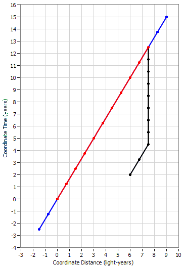

Say you forget about this problem and digress a bit about another. Say Stella is at Earth and then there is a space station which is at 6 light years away and is moving towards her with 0.6 c, then with rest frame of Stella what would you conclude as to when the Space station will reach earth? 10 years or 8 years? I would say 10 years and I would think you will agree with that.

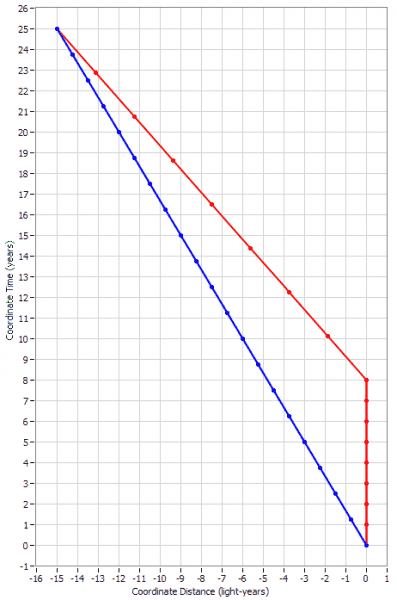

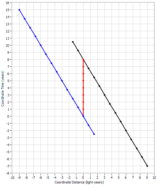

It's 10 years of Coordinate Time in Stella's rest frame as shown here with the Earth in blue, Stella in red and the Space station in black:
But if we transform to the Space station's rest frame during the "trip", it's 8 years of Coordinate Time and also 8 years of Proper Time for the Space station:

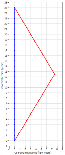

controlfreak said:
Now what is the difference between this formulation and the original scenario. Both scenarios Stella is at rest and distance covered is measured from Stella's frame of reference and space station is moving towards Stella at 0.6 c and so why in one case space contracts and in the other case it doesn't and why in one case it should take 8 years coordinate time and 10 years coordinate time in the other case?
There's no difference if you compare them in the same way. Here is Stella's trip to the Space station in the Earth rest frame:
And here we transform to Stella's rest frame durijng her "trip":
Note that in both cases, in the Earth rest frame the distance traveled is 6 light-years and it takes 10 years. Also in both cases, in the rest frame of the "traveler", it takes 8 years and the distance "traveled" is 4.8 light-years which is also the distance between the Earth and the Space station (prior to its departure in the second case).
Does this make sense to you now?
You have just changed the scenario to a new one where Stella travels for 10 years out and 10 years back instead of 8 like I specified. No problem with that as long as you realize it's a different scenario. Here is a spacetime diagram depicting your new specification:
As I said, it just means you changed to a new scenario. Here is the spacetime diagram we get when we transform it to Terrence's rest frame:
Note that the Proper Times are the same in both these frames for your new scenario, just like they were in both frames of my original scenario.
But what I don't understand is why you don't have a similar problem with your new scenario that you had with my original scenario? Can you explain that?
So this is my fundamental issue which has been troubling me. Let us look at what are the inputs to the ST Diagram creation program for creating each diagram. The fundamental input is the distance between the two points between which the travel happens. Then the velocities to calculate the slope of lines and the rest will take care of itself. So my problem is with the calculation of the primary input to these diagrams. The velocity is held constant across reference frames and that is good. But when reference frames changes, the distance has changed.
Here it in the below picture when it is Earth and space station as the rest reference frame, the distance is 6 light years.
But in the case of Stella's rest reference frame the distance is seen as 4.8 light years.
So before looking further at the diagrams, I am not comfortable in change of choices wrt distances between the two diagrams.
Suppose you ask two people to look at these pictures one each separately and independently without telling them what is what and also don't color them and remove the black line.
The person 1 who saw the first picture would say this is a ST diagram of someone traveling towards the right away from another person (who is at rest) to a place 6 light years away at speed 0.6c.
The person 2 who saw the second picture would say this is a ST diagram of someone traveling towards the left away from another person (who is at rest) to a place 4.8 light years away at speed 0.6c.
Now I ask the person 2 to draw a ST diagram in the rest frame of the traveling person. Note he doesn't know that Earth is supposedly traveling in the second diagram. In effect I am asking him to draw a diagram with Earth at rest. But what he will do if he follows the method we have used to change reference frames, he will further contract the distance from 4.8 light years to 3.84 light years as he truly doesn't know who is the traveller. Is that right? Or if we change the reference frame should we get the original distance of 6 light years from where we stared this contraction process while changing reference frames.
I am not sure if we can say the rest frame of Earth is different from rest frame of the "traveler" wrt distance and velocity. Because in the rest frame of the traveler he is not traveling and so all conception of traveling shouldn't come into picture in drawing the picture and so distance should remain at 6 light years. Otherwise we are not dealing with full frame equivalence if we hold onto the memory of his traveling capability and traveling sensation when drawing the diagram in his rest frame and reducing the distance to 4.8 light years. The distance has to be an invariant in both frame which it is not and the variable distance is calculated using the prior knowledge of who is the traveler and we use it to manipulate the rest frame of the prior traveler. That is what rankles me philosophically though I understand how to calculate the new distance and draw the diagram appropriately.
I also realize this change in distance is arising due to lorentz contraction of space before the "traveler" which Nugatory has been talking about. I have been thinking about his comment. But in anycase in the rest frame of Stella as she is at rest the space she looks at shouldn't contract. Why is it necessary for us to assume it contracts even though she is at rest and in Stella's rest frame, only Earth is the traveller. Why do we give prominence to Earth's reference frame? If you are resident of Stella's world (stella's reference frame) would you have thought like that because all along you will be thinking Earth is the "traveller". I feel we think like residents of Earth and calculate the physics of Stella's world.
Please also let me know what is the tool you use to draw these diagrams. Thank you.
It's due to length contraction. Nugatory already explained this.
Yes, with the added fact that the place 6 light years away is also at rest.
No. They would say it is a ST diagram of someone riding along on one object (the Earth) moving to the left at 0.6c, then leaving it and sitting at rest for a while, and then meeting another object (the space station) moving to the left at 0.6c, 4.8 light years behind the first one, and riding along with it.
Length contraction is not a contraction of "space". It's a contraction of lengths of objects and distances between objects, when those objects are moving.
Yes I should have said distance not space.
I mentioned that we should remove the black line before showing the pictures. So there is no space station according to these ST diagram viewers. And it could even be that she has been at rest all the while and sees Earth passing her to the left moving at 0.6 c. The red line starts only at zero time and so not sure if she was on Earth before zero.
  • #31
Why? Even if there is no object there, it still marks the "point in space", according to the Earth frame, where Stella stops. In any other frame, that "point in space" is moving, not at rest; so we need the black line to tell us where it is.
Well, you're the one that made up the scenario. What do you want her to do? If she is at rest the whole time, then the red line extends vertically through the entire diagram, and the description becomes: it's a ST diagram of someone sitting at rest and being passed by two objects moving to the left at 0.6c that are 4.8 light years apart. None of that changes the main point, which is that the way a person would describe this second ST diagram is not what you said. That is, you were thinking of it incorrectly, which naturally means you're going to come to incorrect conclusions.
  • #32
That is exactly the place where I needed to rethink my though process wrt distances and that is the key. I see what you are saying. At time zero, from Stella's perspective , when Earth is at the same place as she is, the distance between the space station and Earth is 4.8 light years as Station and Earth are moving at 0.6c and hence distances between them should be contracted through Lorentz contraction to 4.8 light years. That means at time zero there are two people (Stella at rest and Earth guy moving at 0.6 c wrt Stella) side by side. And at time zero, Stella and Earth guy both see the same person on the space station and they both come to different conclusions that he is 4.8 Light years away and 6 Light years away from them respectively. Suppose the Earth guy has a measuring scale on Earth which is 6 Light years long - he uses that scale and touches the space station guy and gets convinced that he is 6 Light years away. But Stella will look at this and say the measuring scale is just 4.8 light years long. This is all happening at time zero. Suppose there are other observers at varied velocities (wrt Stella) side by side to Stella at time zero, they will all measure different values for the distance between them and the space station. Let us say all stand in a line hold a large rod which touches the space station - each observer will look at rods of all the other observes and say all rods are equal in length meaning the start and end points of all the rods coincide. But when asked for a number for the length each will say different numbers - one will say 4.8 and the other will say 6. This is because their measuring systems are out of sync and not the reality they see.
This brings us to the fundamental question as to what is distance in space or what is meant by size/length of an object or any measurement in space. All these space measurements are only relative to the reference measuring system of the measurer. The size of the universe or galaxies or planets are all different from the perspective of the guy who measures depending on how he moves relative to others. Distances, lengths and sizes are relative and lies in the eyes of the beholder!
With this understanding and acceptance of this idea, I can now see how the paradox is solved. I have to now convince myself further whether this understanding is truly sound by understanding experimental data which attests to this understanding.
Thank you for that right push. I suppose I am right in the way I have formulated my understanding of how things are wrt distances.
That's not quite how my program works. The inputs consist of a velocity and the number of ticks of the Proper Time unit. The program then calculates the x,t coordinates of each tick and transforms them to create each new diagram. It's not going to make a mistake.
I created my own tool.
  • #34
Thank you for the response.
Let me understand this.
For the below diagram to plot the red and blue line wrt a rest frame moving at a speed 0.6 c right wrt Earth
Are these the inputs you provided?
The velocities :
Red line velocity -> Zero velocity for first part of the journey and (-1.2/1.36 c) for the second part of the journey
Blue line velocity -> (- 0.6 c)
The proper time ticks :
Red line - 8 ticks for the first half and 8 ticks for the second half
Blue line - 20 ticks for the entire journey
  • #35
