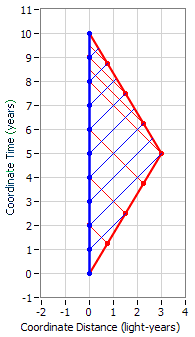

When the rocket twin leaves earth, both twins see the other ones clock ticking slower than their own and by the same factor. When the rocket twin turns around, he immediately sees the Earth twin's clock ticking faster than his own but the Earth twin won't see this same thing happen until a long time later. If the rocket twin travels at the same speed coming back as he did leaving (according to the Earth's rest frame), then the slower factor and the faster factor are the inverse of each other. Since it takes him just as long to reach his turnaround point as it does for him to get back, we can average those two factors and this will tell us the ratio of the Earth twin's aging to the rocket twin's aging. For example, let's suppose that the rocket twin sees the Earth twin's clock ticking at a factor of one-half during the outbound half. Then he will see a factor of two on the way back. The average of 0.5 and 2 is 1.25 so the Earth twin ages 1.25 times whatever the rocket twin ages.
Here is a spacetime diagram to illustrate what I have been saying. The Earth twin is shown as the thick blue line with dots marking off increments of one year. The thick red line is the rocket twin. The thin lines show yearly signals propagating at the speed of light from each twin to the other one.
Notice how the red twin's clock takes 1.25 times longer to tick out one year while he is traveling than when he is stationary. Time Dilation is only affected by speed, not by acceleration. Also note the relative factors of 0.5 at the beginning and 2 at the end and note their average is the same as the ratio of the twins' aging. Blue ages by 5 years while red ages by 4.

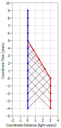

Let's assume that prior to the rocket twin departing from the distant planet toward earth, their clocks have been synchronized according to their mutual rest frame which means that they each see the other ones clock at an earlier time than their own and by the same amount. Let's assume they were three light-years apart. They would each see the other ones clock three years earlier than their own. Then when the rocket twin starts his trip toward earth, he will immediately see the Earth twin's clock advancing faster than his own. Eventually, he will see the Earth twin's clock go through those three years of time plus whatever length of time it took for him to make the trip (according to the Earth frame). Meanwhile, the Earth twin won't see the rocket twin leave for Earth until three more years go by. Then he will see the rocket twin's clock advance rapidly but for a much shorter amount of time. This results in the Earth twin seeing the rocket twin age less than the rocket twin sees of the Earth twin aging.
Here is another spacetime diagram to illustrate this scenario:

While the rocket twin is moving toward the Earth twin according to the Earth's rest frame, it is only the rocket twin's clock that is ticking slowly. So the increased speed of the signals coming toward the Earth twin is reduced by the slower ticking clock of the rocket twin. On the other hand, the increased speed of the signals coming toward the rocket twin is increased by the slower moving clock of the rocket twin. The net result is that both twins see the other ones clock ticking faster than their own by exactly the same amount. You can see these effects illustrated in the previous drawing.
