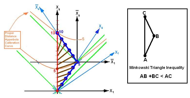

I think yours is the clearest explanation. Here is a space-time diagram illustrating your point. The red guy in the diagram stays home and sees his twin return after 13 red years. But it's only ten years on the blue guy's calendar. The blue guy who made the trip took a short cut through space-time. Each observer moves along his X4 at the speed of light (and T = X4/c), but the blue guy in the diagram took the shorter path as you showed with your integral.

bobc2 said:
You are right about that. But look closely and you will see that I included that hyberbolic calibration curves ...
Of course the caveat was not meant for you :-)
bobc2 said:
What do the diagonal red lines represent?
Interesting you should ask. The slanted lines are there to show the relative progress of each observer as they move along their respective 4th dimensions at the speed of light. When the traveling twin meets up with the black stay-at-home twin, the home twin is 13 years while the twin guy is 10 years. But wait--the home twin really couldn't be there could he -- if he has so far moved at the speed of light along his X4 to just his own proper time 10 yr point on X4?
If you think of observers moving at light speed along their 4th dimension, the home twin hasn't really arrived yet. But this is one reason why many physicists have concluded that objects in 4-dimensional space are 4-dimensional themselves. Thus the travel twin is meeting up with a different cross-section view of home twins 4-dimensional body. And the physical bodies really aren't doing any traveling anyway, because they are four-dimensional objects fixed --frozen in a 4-D universe.
It's ugly, I know. My subjective self does not want to accept that picture at all, but as I've said before, there is no alternative external objective picture out there that contradicts the 4-dimensional universe populated by 4-dimensional objects. I think many just abandon the idea of an external objective reality.

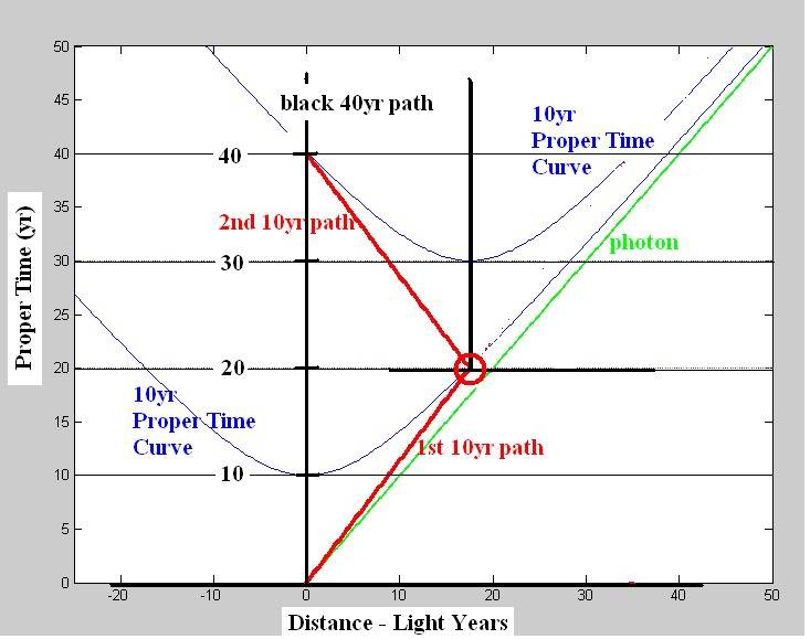

Here's another example. The hyperbolic calibration curves were computed in MatLab. Notice that when the home twin is 20 yrs old his view of the universe includes the travel twin with his (red's) clock showing 10 yrs. Red (travel twin) is about 17.5 light-years away from home (along the black X1 axis, going about 0.875c) at this point. That's the usual time dilation.
bobc2 said:
Interesting you should ask. The slanted lines are there to show the relative progress of each observer as they move along their respective 4th dimensions at the speed of light. When the traveling twin meets up with the black stay-at-home twin, the home twin is 13 years while the twin guy is 13 years. But wait--the home twin really couldn't be there could he -- if he has so far moved at the speed of light along his X4 to just his own proper time 10 yr point on X4?
Shouldn't one of these be 10 years? But I still can't make any sense out of what you are saying. Do you really think this kind of explanation helps someone learn Special Relativity?
Don't you mean length contraction?
And your example would fit better if you used a speed of 0.866c with a distance according to the traveling twin of 17.32 light-years away at his turn-around point. This would make the traveling twin 20 years old when he met up with his 40 year-old stay-at-home twin as you graphic depicts.
These discrepancies make it very difficult to follow what you are presenting.
You are right of course. It was a typo. The travel twin is 10 yrs and the home twin is 13 yrs when they meet.

Your tone seems a little confrontational, and I have no interest in participating in confrontational discussions and don't think it's good for the forum.
No. I was specifically referring to the time of 10yrs on the travel twin clock as seen in the the black's world at the black 20 yr point.
That's why I said "approcximately 17.5 yrs. But, you're right. Thanks for giving us the exact numbers.
