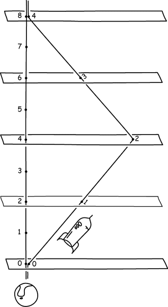

In the simple twin paradox, one twin stays at home and the other travels to a distant destination and back again at a substantial fraction of the speed of light. We can assume that the traveling twin accelerates to a fixed speed almost instantaneously when he leaves, when he turns around and that he stops quickly when he returns home. The traveling twin moves with constant velocity on the long outbound and inbound legs of the journey.
With this scenario in mind, here's another clock comparison method:
Prior to the trip, a number of clocks are placed at intervals along the path that the traveler will take to the destination.
All of these clocks along the path to the destination are placed so that they are stationary wrt the home clock. That is, all these clocks are at rest in the same inertial frame with the home clock.
Using Einstein's clock synchronization method, we synchronize all of these clocks with the home clock.
The clocks along the traveler's path then represent "home clock time" in the home clock's inertial frame. Since this frame is inertial throughout the trip we know that the established synchronization of these clocks with the home clock persists throughout, in the home frame.
The traveler can read these distributed "home clocks" during his trip and compare them with the readings with his own clock. Then he has an answer to how and where he is losing time relative to the home clock. The comparison is illustrated in this diagram linked from http://www.pitt.edu/~jdnorton/teaching/HPS_0410/chapters_2013_Jan_1/spacetime_tachyon/index.html (sorry for the size):
Copyright John D. Norton. January 2001, September 2002; July 2006; February 3, 2007; January 23, September 24, 2008; January 21, 2010; February 1, 2012.
In the diagram the rocket twin travels at 86.6% the speed of light resulting in a time dilation factor of 1/2. The straight vertical path is the home clock's path over time (the home clock's worldline). The dogleg is the traveler's worldline. Each is marked with the proper time in years on each of the twin's clocks. The horizontal planes show the positions of the home clocks (imagine the line of clocks) and of the traveler at different times in the home frame.
The travel reads the "home time" using the clocks placed along the plane. The traveler finds the following correspondence between home time and the time on the own clock (as shown in the diagram):
Clock readings in years
Home Traveler
0 0
2 1
4 2
6 3
8 4
When the traveler returns he can show the home twin the above record, so the home twin can know in his own frame how old the traveler was when he was a certain age.
There is no mystery about where these clocks get out of sync from this perspective. They do it uniformly along the entire trip.
Acceleration does not directly affect the clocks, it is the speed of the traveler and the time over which he travels with that speed that determines the age gap. The above clock comparison exactly reflects the time dilation of the traveling twin which is constant throughout the trip.
Note that the traveling twin could, instead of traveling far away, make small circles around home at the same speed for the same amount of time and the clock results would be the same. So it appears that it has little to do with how far away he travels.
Acceleration does not affect the age difference directly but the acceleration is necessary to follow any non-straight path through flat spacetime.
The twin paradox is "why can't we just reverse the role of the home and traveler in the diagram, such that the traveler is considered stationary and the home clock is considered to move, so that the traveler gets older instead"? We cannot because the traveler's path through spacetime cannot be made a straight line in any such diagram. It is a dogleg in all inertial frames, while the path of the home clock is straight in all inertial frames.

When you look at the problem using "home time" (as in the OP), acceleration appears to have nothing to do with the clock differences.
When you look at the problem from the traveler's frame, you see that it is precisely the traveler's acceleration (and distance from home) that is causing the simultaneous values on the home clock to rapidly change at turn around.
(On the other hand the traveler's rapid acceleration when he leaves and rapid deceleration when he returns has very little effect because the distance from the home clock is small.)

You have already done so. Your entire OP is a description of how the traveler will interpret his observations using the simultaneity convention of the "home" frame. Your table of corresponding values of traveler clock time vs. home clock time only makes sense if the traveler is using the simultaneity convention of the home frame.
For example, when the traveler passes the home clock reading "2" and his own clock reads "1", if he concludes that he has "lost" 1 unit of time compared to the home twin, he is implicitly assuming that the reading of "2" on the home clock he just passed is simultaneous with the reading of "2" on the home twin's clock. But if he were to use the simultaneity convention of his own rest frame at that instant, that would not be the case; the reading of "2" on the home clock he just passed would be simultaneous with an event on the home twin's worldline where the home twin's clock read much less than "1".
