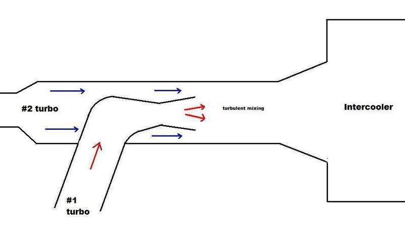

I'm converting my turbo system from a single turbo to a sequential twin turbo system. Where the two turbos intercooler pipes join, the flow from the first turbo to spool can easily reverse back through the second turbo to spool, unless you have a one way valve like a swing check valve to stop this happening.
What I would like to do is eliminate the swing check valve by using an air ejector design with the first turbo's intercooler pipe to stop the flow reversing back through the second turbo's intercooler pipe. Here is a diagram I have done.
Could this design work such that at all stages of both turbos boost from vacuum to full boost, there would be no flow backwards to the second turbo?

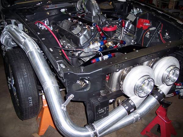

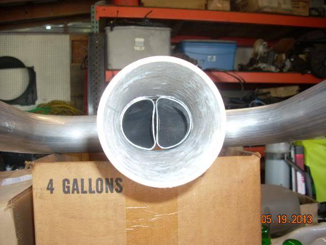

Google "twin turbo merger" and you will see plenty of smooth transitions into the throttle/carb. If you have similar turbos being fed by equal banks of exhaust the rest of it "will work itself out".
This is a sequential twin turbo setup I am doing which means one turbo makes boost first while the other one is making no boost. The pic you show is one of the better designs, but I still don't think that I can merge the intercooler pipes like your pic shows otherwise the boost from the first turbo will still partly flow back out the second turbo (as it is making no flow or boost) instead of it all going out through the intercooler. This is because the flow path back out through the second turbo presents less resistance to the first turbos boosted air then going through the intercooler does.
What the air ejector method should do is turbulently mix the air from the first turbo (which is at high speed and pressure) with the atmospheric pressure air in the second turbo intercooler pipe. This mixing should impart forward velocity to the second turbos static air resulting in it also moving towards the intercooler, albeit at a slower speed. The more mixing that occurs, the better this idea will work and the less chance that any air will flow backwards out the second turbo.
That's why I'm hoping someone with more maths skills then me can help work out (or point me in the right direction) if my idea of using an air ejector design for the pipe merging will achieve maximum mixing of the air and result in no air ever flowing backwards out the second turbo.

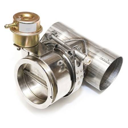

This should solve the exhaust part.
The EGCV (exhaust gas control valve) design I like the best is this one as it is boost activated, but unfortunately they are out of stock at the moment.

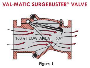

The intake check valve design I like the best is this one. It is a swing check valve so should have very little flow resistance.
I'd still like to be able to have the intercooler pipe merging done so that there is no need for the swing check valve though, and I still think that the air ejector design should be able to achieve that.
