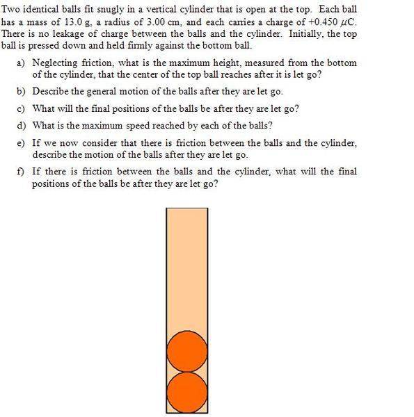

The entire problem is in the attachment.
F = k*(|q||q0|)/(r^2)
F = 8.99e9(.450uC*.450uC)/(3cm^2) = 6.068e8
This problem has me completely lost and I am turning to you guys as my last resort. I solved for F and have no idea what to do after this. Any sort of insight would be appreciated and I can provide formulas upon request. Thank you.
Think in terms of energy, not force, for most of the questions.
I could use a little more guidance than that. What kind of process should I follow to solve part A?
Apply conservation of energy. What forms of energy are relevant here and how would you calculate them?
PE = mgh?

Due to their electric field, those charges will have electric potential energy. Look it up!
Electric Potential Energy: PE = k((q1*q1)/r)

Now see if you can come up with an expression for the total mechanical energy.
TME = 1/2mv^2+mgh+k((q1*q1)/r)
Good. But use the same distance r for both gravitational and electrostatic PE.
So your saying that both h and r should be .03m? And I am solving for velocity?
1/2(.012)(v^2) + (.012)(9.8)(.03) + (8.99e9(.45uC*.45uC)/(.03))?

What's the velocity at the initial position? And at the highest position? (You're solving for that highest position.)
You'll take advantage of the fact that the total mechanical energy remains constant. Evaluate it at the initial position.
Okay so the r is going to be equal to .06m.
The velocity at the initial position is zero, so I set v = 0?
1/2(.012)(0) + (.012)(9.8)(.06) + (8.99e9(.45uC*.45uC)/(.06)) = .03739725
I didn't check your arithmetic, but that's the right idea. Now set up a general equation and solve for the value of r at the final position.

Yes, but since TME is conserved it is the value for any r.

Almost. But don't plug in any values for r. (Like your second term.)
(And make sure you use the right charges. .45μC = .45e-6C, not .45e9C.)
Alright, my final question is about the non mathematical part. Letters b-f (Correct me if I am wrong). When the balls are released the top one should reach a max height and then float above the second one because they repel each other. But then what happens when the friction comes into play?
I'd say that the top ball will reach a max height then fall back down to the lowest point again. It will keep oscillating, as energy is conserved.
Eventually friction will dissipate the energy and the ball will end up at some equilibrium position.

This depends upon the height of the cylinder versus the equilibrium position of the top ball.
It may continue to oscillate above the cylinder.
