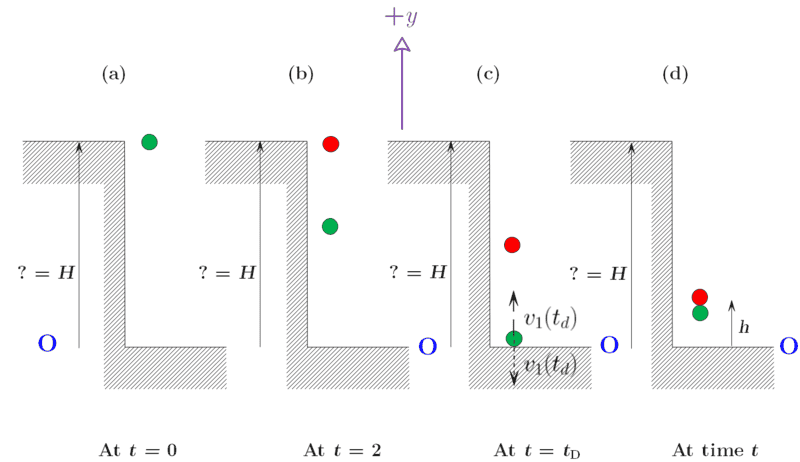

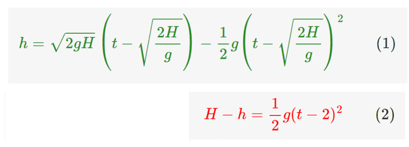

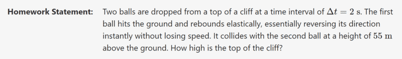

Two balls are dropped from a top of a cliff at a time interval of ##\Delta t = 2\;\text{s}##. The first ball hits the ground and rebounds elastically, essentially reversing its direction instantly without losing speed. It collides with the second ball at a height of ##\text{55 m}## above the ground. How high is the top of the cliff?
For uniformly accelerated motion under gravity, taking ##g = +9.8\;\text{m/s}^2##, we have the position after a time ##t##, ##y(t) = y_0+v_0t-\frac{1}{2}gt^2\;\text{(I)}## and the velocity ##v(t)=v_0-gt\; \text{(II)}##. The velocity can also be expressed as a funtion of the position ##y## from the origin, ##v^2(y)=v^2_0-2gy\;\text{(III)}##.
I draw a series of images of the problem situation. In (a), the first ball in green is (just) dropped at time ##t=0##. In (b), the second ball in red is dropped at time ##t=2\;\text{s}##. In (c), the first ball rebounds after a total time of falling down ##t_d##. At this position, its velocity ##v_1(t_d)## is the same in either direction. In (d), the balls meet after a total time of flight ##t## at a height ##h##. The sign convention is positive ##+## in the upwards direction and all distances measured from the ground as the origin ##\color{blue}{\textbf{O}}##.

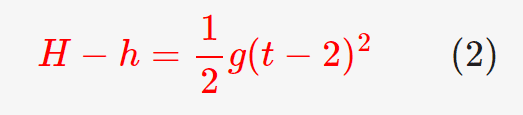

For the second ball at collision point, ##y_2(t) = h = H - \frac{1}{2}g(t-2)^2##, from which we have its equation of motion,
\begin{equation*}
\color{red}{H-h =\frac{1}{2}g(t-2)^2} \quad\quad (2)
\end{equation*}
For the first ball at the time colliding, we can again write ##y_1(t) = h##, but we have to be careful here because the motions, first down and then up, take place after a change of acceleration to infinity at the point where the ball hits the ground after a time ##t_d##. We have to do each part separately.
Let ##t_u## be the time the first ball takes from the time it rebounds to collide with the second. So we have at the time of collision, ##t = t_d+t_u##. We can find the time for the downward motion easily, ##t_d=\sqrt{\frac{2H}{g}}##. Hence we have ##t_u = t-\sqrt{\frac{2H}{g}}##. The velocity following this downward motion ##v_1(t_d) = \sqrt{2gH}##. For the subsequent upward motion of the ball, ##h = v_1(t_d)t_u-\frac{1}{2}gt_u^2##. Hence the equation of motion of the first ball on its way up,
\begin{equation*}
\color{ForestGreen}{h = \sqrt{2gH}\left(t-\sqrt{\frac{2H}{g}}\right)-\frac{1}{2}g\left(t-\sqrt{\frac{2H}{g}}\right)^2} \quad\quad (1)
\end{equation*}
From equation ##(2)##, we have ##t=\sqrt{\frac{2(H-h)}{g}}+2##.
Inserting this value of the time ##t## in equation ##\text{1}##, we get
$$\small{h = \sqrt{2gH}\left( \sqrt{\frac{2(H-h)}{g}} +2-\sqrt{\frac{2H}{g}}\right)-\frac{1}{2}g\left\{ \frac{2(H-h)}{g} +2 -\sqrt{\frac{2H}{g}}\right\}^2}$$
Upon expanding the equation above, it looks hopeless trying to express ##H## as a function of ##h##.
Request : A hint to solve the problem.

I think I found an algebraic path, but its messy.
I start with the finding the time for the first ball to bounce, and then the position, velocity of the second ball at that time. After that I rewrite the EOM for each ball in terms of ##g,H,##, and ##\Delta t ##( the delay) and restart the clock, to find the time they will meet ##t_x##. The position of the ball that has bounced is ##h## at that time, and the position of the second ball is ##H-h##.
You can then solve for ##t_x## in terms of ## g,H,h,\Delta t##
Then plug ##t_x## back into the position equation of the ball that has bounced.
And you are left with an equation in ##g,H,h,\Delta t ## with the only unknown ##H##. I didn't carry on to see if its analytical (looks quite messy - but I have been shocked many times on looks before too )
EDIT: I didn't realize the OP already found an expression in these variables. Whoops!
for your solution in the OP I think make the substitution:
##U= \frac{2(H-h)}{g} + \Delta t - \sqrt{ \frac{2H}{g}}##
And solve the resulting quadratic in ##U##
Then you will be left with something like:
$$ \left( \frac{2(H-h)}{g} + \kappa \right) = \pm \frac{1}{g} \sqrt{ \beta + 2 g h } $$
Where ##\kappa## and ##\beta## are just constants.
Then square both sides and I think you will be left with a quadratic to solve in ##h##.

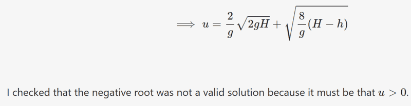

Last try:
let ##U = t - \sqrt{\frac{2H}{g}} ## from eq(1)
solve (1) for ##U##
$$ u^2 - \frac{2}{g} \sqrt{2gH} u + \frac{2}{g}h = 0 $$
$$ \implies u = \frac{2}{g} \sqrt{2gH}+ \sqrt{ \frac{8}{g} \left( H - h \right)} $$
I checked that the negative root was not a valid solution because it must be that ##u > 0##.
so we have:
$$ t - \sqrt{ \frac{2H}{g}} = \frac{2}{g} \sqrt{2gH}+ \sqrt{ \frac{8}{g} \left( H - h \right)} $$
sub for ##t## you found from 2
$$ \sqrt{ \frac{2}{g} \left( H - h \right)} + \Delta t - \sqrt{ \frac{2H}{g}} = \frac{2}{g} \sqrt{2gH}+ \sqrt{ \frac{8}{g} \left( H - h \right)} $$
Then massage what is under the roots
$$ \frac{1}{2}\sqrt{ \frac{8}{g} \left( H - h \right)} + \Delta t - \sqrt{ \frac{2H}{g}} = \frac{2}{g} \sqrt{2gH}+ \sqrt{ \frac{8}{g} \left( H - h \right)} $$
$$-\frac{1}{2}\sqrt{ \frac{8}{g} \left( H - h \right)} = \frac{2}{g} \sqrt{2gH}+\sqrt{ \frac{2H}{g}} - \Delta t $$
more massaging of the RHS:
$$-\frac{1}{2}\sqrt{ \frac{8}{g} \left( H - h \right)} = \frac{2}{g} \sqrt{2gH}+\frac{1}{g}\sqrt{ 2gH} - \Delta t $$
$$ -\frac{1}{2}\sqrt{ \frac{8}{g} \left( H - h \right)} = \frac{3}{g} \sqrt{2gH} - \Delta t $$
Square both sides:
$$ \frac{2}{g}\left(H - h \right) = \frac{18}{g}H - \frac{6 \Delta t}{g} \sqrt{2gH} + {\Delta t}^2 $$
Isolate the root on the RHS again, square both sides and solve the resulting quadratic in ##H##.
At least I hope I haven't bungled again.

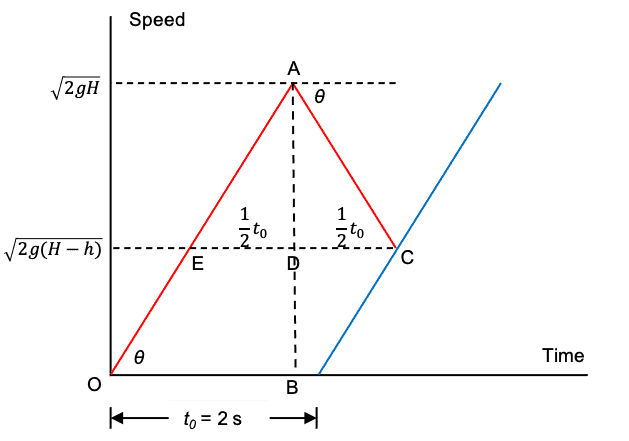

One can easily set up the relevant equation by using a speed vs. time graph. Shown below is the speed of the first ball in red and the second ball in blue. The point of intersection C is the collision point at the time when the speeds are equal as required by energy conservation. The velocities are in opposite directions, of course.
The height of the cliff ##H## is the area of triangle OAB. The base of this triangle is the time it takes the first ball to hit the ground ##OB=t_f=\sqrt{\frac{2H}{g}}.## Triangle EAD is similar to OAB. Therefore, $$\frac{(AD)}{(AB)}=\frac{(ED)}{(OB)}\implies \frac{\sqrt{2gH}-\sqrt{2g(H-h)}}{\sqrt{2gH}}=\frac{\frac{1}{2}t_0}{\sqrt{\frac{2H}{g}}}.$$
On edit
Edited to fix the incorrectly applied "area under the curve" equation.

Let me start with the statement of the problem as a refresher.
Hint : ##\text{The first ball takes exactly 1 s from the time it rebounds to where it meets the second ball.}##
The first ball is always a time of 2 s ahead of the second ball. However, this does not mean, as a digression, that their distance of separation remains the same. But whatever mark along the cliff the first ball passes, the second ball also will, 2 s later. The first ball passed the position of collision (which happened later on) which is given to be at a height of ##h = 55\;\text{m}## above the ground. Since it rebounded with the same speed with which it struck the ground, it would climb back to the height ##h## taking the same time that it took to descend. Again, as a digression, note that this is true for all subsequent heights climbed by the first ball, if it was allowed to, due to the symmetry of free fall motion. However, something special happens at the given height ##h\;-\;## when the first ball reaches that height, the second ball meets it to collide. Since the first ball was 2 s ahead of the second ball, it must have taken the first ball a time of 1 s to travel to and from the height ##h## to the ground!
Attempt : With the hint above, the solution of the problem is straightforward. The time taken by the first ball (in green) to meet the second (in red) after collision is what I call ##t_u = \frac{\Delta t}{2} = \frac{2}{2} = 1\;\text{s}##. Using ##y(t) = y_0+v_0t-\frac{1}{2}gt^2## for this rebound motion, we have ##\small{h = v_1(t_d)t_u-\frac{1}{2}gt_u^2\Rightarrow 55 = v_1(t_d)-5}##, taking ##g = 10\;\text{m/s}^2##. This leads to ##v_1(t_d) = 60\,\text{m/s}##, as the speed with which the first ball hits the ground and rebounds after a time of flight ##t_d## downward. We need not find this time, because using the third ##\text{(III)}## of the relevant equations given above, viz. ##v^2(y)=v^2_0-2gy\;\text{(III)}##, ##v_1^2(t_d) =v_0^2-2gH\Rightarrow H = \frac{v_1^2(t_d)}{2g}=\frac{60^2}{2\times 10} = \boxed{180\; \text{m}}\color{green}{\large{\checkmark}}##, as ##v_0=0## due to fall from rest.

Sorry to bother @erobz . I am stuck early on in the solution you provided in post #18, unsure what you meant by equations (1) and (2). Can you clarify?
Fair warning I haven't taken it the full way through, because the last step is still quite laborious\tedious.
The equations I'm referring to are the equations you found in the OP. You have them labeled ##(1)## in green, and ##(2)## in red.

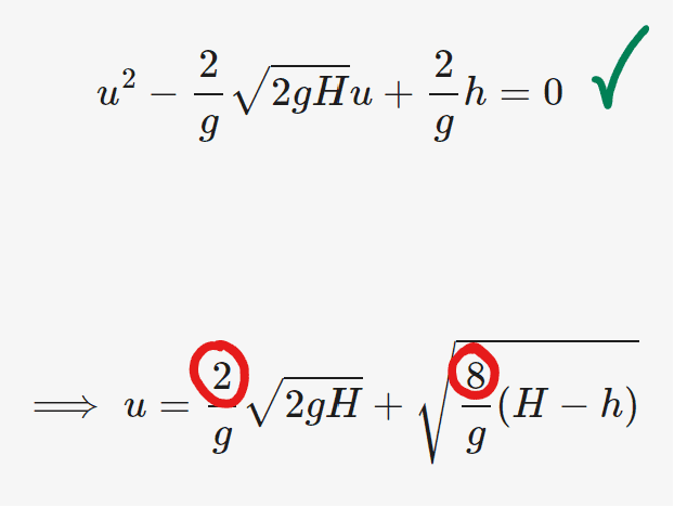

Hi @erobz, can you check your working that I put below which you did in post #18 above? I think you are off by a factor of 2. I put your workings on the right, with the mistakes in red ink.
Let me copy and paste what I am getting. I mark the final expression for ##u## in orange.
What's more, I did not understand your reason for keeping the positive (##+##) sign for ##u##. I copy and paste your reason to the right.
Indeed, ##u = t-\sqrt{\frac{2H}{g}}## and since ##t>\sqrt{\frac{2H}{g}}\Rightarrow u>0##. But is that the reason to keep the ##+## sign?
See my reasoning below to the right on dark page.
What I am saying basically is that the second term is less than the first in the expression for ##u##. So keeping the ##-## sign continues to keep ##u>0##.
Many thanks.
View attachment 339078What's more, I did not understand your reason for keeping the positive (##+##) sign for ##u##. I copy and paste your reason to the right.
Many thanks.
Yes, you are correct on both accounts. I goofed on the algebra, and one of the solutions cannot be ruled out by negative time.
So if both solutions are positive for ##u##, must we then take the smallest of the two as the desired solution? ( i.e. ## u = \frac{1}{g}\sqrt{2gH} - \sqrt{\frac{2(H-h)}{g}} ## ) or do we just work with both solutions ##\pm## ( I'm leaning towards the former)?

@erobz, you were right. I think I have solved it, though a question lingers. Since it has been sometime that I have posed the problem, let me state things from the beginning to refresh.
Attempt :
Taking ##g = 9.8\:\text{m/s}^2##, we have the equation of motion of the first ball as (see my post #1) shown on the right. Here ##h## is the height where the balls meet, ##t## is the time when they meet (from the start, when the first ball was dropped). The equation of motion of the second ball (see my post #1) is also shown on the right. The question is now to find the height of the cliff H (=?).
In ##(1)##, let us put ##\color{blue}{u = t-\sqrt{\frac{2H}{g}}}\qquad \color{brown}{(3)}##
This, after some algebra, we obtain ##\small{u^2-\sqrt{\frac{8H}{g}}u+\frac{2h}{g}=0\Rightarrow u = \sqrt{\frac{2H}{g}}\pm\sqrt{\frac{2(H-h)}{g}}=\sqrt{\frac{2}{g}}(\sqrt H\pm \sqrt{H-h})}##
Substituting from ##(3)## for ##u=t-\sqrt{\frac{2H}{g}}=\sqrt{\frac{2}{g}}(\sqrt H\pm \sqrt{H-h})\Rightarrow t = \sqrt{\frac{8H}{g}}\pm \sqrt{\frac{2(H-h)}{g}}##.
From equation ##(2)##, we have ##\sqrt{\frac{2(H-h)}{g}}=t-2\Rightarrow \color{blue}{t = \sqrt{\frac{8H}{g}}\pm (t-2)}\qquad \color{brown}{(4)}##
There are two possibilities to ##(4)## as evidenced by the ##\pm## sign.
##1. \;\mathbf{(-)\,\text{sign}}## :
This yields from ##(4)##, ##2t-2 = \sqrt{\frac{8H}{g}}\Rightarrow t= \sqrt{\frac{2H}{g}}+1\Rightarrow t-\sqrt{\frac{2H}{g}}=1\quad(=u)##. Putting this value of ##t## in ##(1)##, we have,
##\small{h = \sqrt{2gH}-\frac{1}{2}g\Rightarrow h+\frac{1}{2}g = \sqrt{2gH}\Rightarrow 55+5=\sqrt{20H}\quad\text{(putting values here)}\Rightarrow 60^2=20H\Rightarrow} \boxed{H = 180\,\text{m}}\quad\large{\color{green}{\checkmark}}##
This agrees with the answer.
##2. \;\mathbf{(+)\,\text{sign}}## :
This yields from ##(4)##, ##t=\sqrt{\frac{8H}{g}}+t-2\Rightarrow \sqrt{\frac{8H}{g}} = 2\Rightarrow H = \frac{4g}{8}= 5\,\text{m}\quad\huge{\color{red}{\times}}##.
Of course this answer is incorrect, as the problem states that the ball collide at ##h = 55\,\text{m}##. But it should mean something that I am not able to figure out.

  • #35
brotherbobby said:
##(3)##. Is it also true that for a ball thrown vertically up and which rises to a maximum height ##h##, the time to scale a height ##y## is the same as the time that the ball dropped from the height ##h## will take to fall a distance ##y## down?
[ I cannot show ##(3)## either using symmetry arguments or algebra using the kinematic equations ].
Many thanks.
That can't be the same because the initials speeds are different.
For an elastic ball, the time to fall from height ##h## is the same as the time to bounce back up to height ##h##.
First, we have the same acceleration due to gravity, ##g##. Second, we have the same distance. Third, we have the same final speed in the first case as the initial speed in the second case.
This implies that the initial speed in the first case (speed at height ##h##) is the same as the final speed in the second case (also height ##h##). This can also be seen directly from conservation of mechanical energy. Note that conservation of energy also covers the case of a varying gravitational force/potential.
For constant acceleration, you can use the kinematic equations to show that the time is the same up and down.
