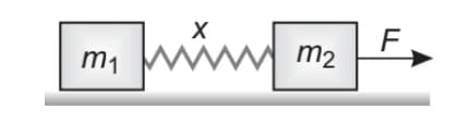

Two bars connected by a spring on a floor with friction
Null_Void
73
Two bars of masses ##m1## and ##m2## are connected by an ideal spring and are kept on a floor with friction. The coefficient of friction is ##k##. Find the minimum constant force to be applied to mass ##m2## in order to shift the bar.
Pic attached below.
##F - kx - μm_1g = m_1a##
##kx= μm_2g##
##Fx - 1/2kx^2 - μm_1gx = 1/2mv^2##
So I do realise that this problem involves energy, I still wrote equations for forces acting on each block. I will assume coefficient of friction to be ##μ## for convenience.
For block 1:
For block 2:
##kx= μm_2g##
I then wrote an energy equation assuming a velocity ##v##:
Say the block moves a distance ##x##
To solve this equation what value of v am I supposed to assume? Do the force equations play any part in solving
the problem?

The question, as I understand it, is: what is the minimum force ##F## such that ##m_1## moves?
Which is equivalent to: what is the maximum force ##F## such that ##m_1## does not move?

Do we know the coefficient of kinetic friction acting on block 2 ##m_2##? It slides at constant velocity for the smallest such ##F## that would release ##m_1##? Or am I missing something, perhaps ##\mu_k = \mu_s = \mu##...
Anyhow to the OP. Forces are going to be the key here.

The first thing to think about is what happens if ##F## is large enough to move ##m_2## but not ##m_1##?
Acceleration is not much use as it's variable.
But shouldn't ##m_2## decelarate? There will be an elongation in the spring which increases with time and at one point the block will be in equilibrium? I'm sorry, but could you tell what would happen?
Equal forces means no acceleration, but ##m_2## keeps moving.

It appears to me that there are some errors and/or typos in the statement of the problem as it is given.
It seems that the intention was that the coefficient of friction is ##\mu## and the spring constant is ##k## .
Then as @PeroK has stated in Post #4 :
I agree with that, where force, ##F##, is applied to the block with mass, ##m_2##, as in the figure.
As a hint, I would include the question:
What is the minimum force that the spring must exert on the ##m_1## block so that it moves?

The minimum spring force should be equal to the friction force
##kx = μm_1g##

That's not the way homework help works. You are supposed to be capable of tackling the problem yourself.
One more hint: imagine that ##m_1## is very large, so that it doesn't move. You could even imagine ##m_1## is fixed to the floor. Analyse the motion of ##m_2## under a constant force. And by "analyse" I mean both a description of the motion and the relevant equations.
If you can do that, then you have almost solved the problem.
##kx = μm_1g##
Right. So the problem reduces to moving ##m_2## a distance ## μm_1g/k##.
Now you can think about work.

I will assume that ##m_1## is fixed to the floor or rather that it is a rigid wall to which the spring and the mass system is connected.
Since the force applied is constant, the block will start decelerating as the spring elongates and at one point of time it will be in equilibrium.
At Equilibrium:
## F = kx + μm_2g##
Using Work-Energy theorem:
##Fx - μm_2gx - 1/2kx^2 = -1/2m_2v^2##
Where ##v## is the initial velocity of the block when it begins to move.
I'm highly doubtful of the sign of the term on the right as it won't give us a proper solution.
But the equation still seems right.

But an extra velocity term ##v## is still present? What value should ##v## take in this case

You need to think about what happens after the equilibrium point.

Is this the equation we should be concerned with?
  • #32
No. That's no use, as you yourself have repeatedly complained about the ##v^2## term being a nuisance.

Will it perform simple harmonic motion about the equilibrium point?
  • #34
No.
Suppose there is still a velocity term at that point. What would happen if you were to make F just a tiny bit less?
