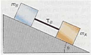

In the diagram mA is equal to 3.00 kg and mB is equal to 1.07 kg. The angle of the inclined plane is 38.0°
(a) Find Acceleration: 6.03 m/s^2 (got this part)
(b) Find the tension Tb in the connecting string: Not sure
(a) a = (F/mA + mB)
(b) t = mA * a? or mB * a? Not sure
Obviously my mA * a and mB * a both didn't work, I'm not sure what the formula should be.
What forces act on each block? Draw yourself a free body diagram for one of the masses. Then by applying Newton's 2nd law, you can solve for the tension.
I'm sorry, but... What?
The force that acts on each block is gravity, 9.8 * sin theta. That's how I got acceleration.
T = m(g+a)? But is that mA or mB?

Right, but you left it out in your two formulas for tension.
Do this. Pick a block. Doesn't matter which. Then find ∑F for that block. Direction matters: call down the incline positive.

Woops, sorry. O_O I missed that.
3 * (9.8 + 6.03) = 47.49
I don't know what the summation F means. Sum of forces on the block?
I usually have practice problems so I can play with them until I figure out how to do them, no such luck on this one.
Yes.
Did you pick a block? Which one? What forces act on it? What's their sum?
