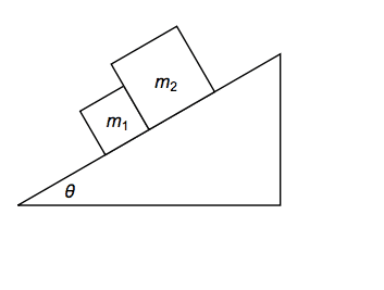

Two blocks slide on an incline of angle \theta . Block 1 has mass m1 and coefficient of kinetic friction μ1 with the surface, block 2 has mass m2 and coefficient of kinetic friction μ2. The gravitational acceleration is g.
In terms of these parameters, under what condition will the blocks remain in contact as they slide?
ΣFm1 = m1gsinΘ- m1g*μ1 = m1a
ΣFm2 = m2gsinΘ- m2g*μ2 = m2a
I am guessing that when the accelerations are both equal to zero, the blocks remain in contact? I am not sure under what conditions the blocks remain in contact with each other.[/B]

I assume there was a diagram showing them initially in contact, one above the other on the plane. Is that right? Which was higher?
What determines which would slide faster?

Ok, so what about the answer to my last question?
I am not given the numerical values for any of the variables, and the question asks that under what conditions the blocks remain in contact with each other. Therefore I assume that m2 must slide faster than m1. m2 is higher according to the picture.
Yes, I understand that.
Did you mean that? How can it overtake the lower block?
I mean in order for the two blocks to stay in contact, m2 must have a higher or equal velocity compared to m1. If not, they would not be in contact? Right? If m2 has a "greater" velocity, it would mean that m1 and m2 would slide together? If that makes any sense...
Ok, you mean that it would have higher or equal velocity if they were side by side instead, right?
Yes, if m2 would otherwise have had the greater velocity they will slide together.
So do you wish to revise your answer to the question?
