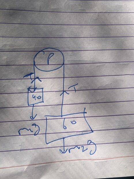

Two bodies of masses m1=40 kg and m2=60 kg are attached to the end of the string of negligible mass and suspended from massless pulley. The acceleration of the bodies(g=10) is-
##F=ma##
. I don’t know what m?

##(T- m1g)-(T-m2g)= ( m)a##. I don’t know what m?
Please explain your rationale for obtaining this force balance. What is your force balance on each of the masses individually?

##(T-m_1g)## because T is upward force and mg is downward force. Direction of the resultant force will be downward. Now ##T-m_2g##. Same reason. Resultant will be that the T > m2g , so upward movement. And final resultant will be difference of these two resultants . So that’s how the required above eqn.
I get where a is the downward acceleration of m2. And I get where a is the upward acceleration of m1. Because of the difference in masses, m1 is accelerating upward and m2 is accelerating downward; but the magnitudes of their accelerations are the same.
Chestermiller said:
get m2g−T=m2awhere a is the downward acceleration of m2.
How can you take + m2g and -T. It should be other way around. T is the upward force and gravity is downward force.
Your first eqn should be
Second should be
But it looks the same.

All you need to know is that the length of rope is constant, and this means that the accelerations of the two masses are equal in magnitude and opposite in direction.

Here are 3 approaches you can use for problems like this. They all boil down to the same thing of course.
Method 1. Consistently use ‘upwards is positive’.
For the left mass:
For the right mass:
and then remember
(as already noted by @Chestermiller)
Method 2. Take the direction of acceleration as locally positive (so each mass has the same positive acceleration).
For the rising left mass: (upwards is positive)
For the descending right mass: (downwards is positive)
Method 3 (for acceleration).
Realise the magnitude of acceleration is the same as that of a total mass of accelerated by a force, F, which is the difference in weights (). Then use . That gives the acceleration very simply; then you can easily find tension if required.
Method 1 is the most general/rigorous and preferred for more complex problems. But Methods 2 and 3 are useful if you understand them well enough to use them appropriately.

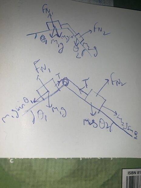

To be clear since the tension is same and opposite(even though it doesn't look in the diagram) the net force is simply the difference of the weights and we can say the system will move in the direction of heavier weight.
But this is not always true as in the case of incline with two masses one hanging from the pulley and other kept on the incline.
https://www.physicsforums.com/threads/two-blocks-a-pulley-and-an-inclined-plane.1011992/

  • #44
'Method 3' (in Post #13) is for solving Atwood Machine problems with both masses hanging vertically.
However if one or both masses are on an incline, Method 3 can easily be modified.
If and are on inclines of and (to the horizontal) respectively, we must consider the downhill component of each weight: and .
For example if then accelerates downhill.
(To get the direction, you don’t actually need to include 'g' as it cancels; you can just compare and .)
The net accelerating force is .
Note:
If we have the Atwood machine.
If and we have on a horizontal surface and hanging vertically.
  • #45
I am not talking about this method. I am asking you to verify what I said.
  • #46
So you are asking for a verification of of the correctness of:
Yes, correct for a single pulley from which two weights are suspended vertically.
Strictly speaking, the system will "accelerate" in this direction and will "move" in that direction if it begins at rest.
And you want a verification of:
Yes. If one or both of the masses slides down a slope (with or without friction), things are more complicated. The heavier weight may not always accelerate down-slope. Or, if friction is high enough, may not move at all.
  • #47
Thanks 😊

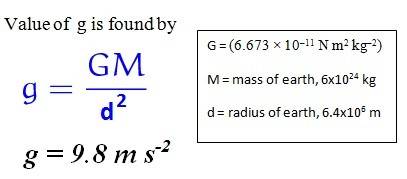

@jbriggs444 I have another question. We know acceleration due to gravity is the acceleration which every body follows no matter what the mass. Both falls at same rate and touch the ground at same time. So why now its changed? Why heavier mass or the incline angle changes this phenomenon? ( and let's assume the friction on incline is zero)
  • #49
Newton's second law.
If you add up all the forces and divide by the mass, you can solve for the acceleration.
If the only force is gravity then and and .
If there are other forces involved such as from strings and inclined planes then acceleration can vary. That is why a mass sitting on a table does not fall through the table at 9.8 meters per second per second.
Likes Lnewqban
