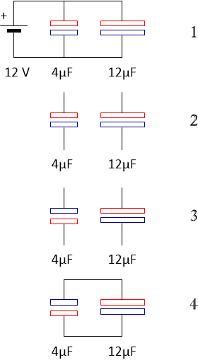

Two capacitors, one that has a capacitance of 4 μF and one that has a capacitance of 12 μF are connected in parallel. The parallel combination is then connected across the terminals of a 12 V battery. Next, they are carefully disconnected so that they are not discharged. They are then reconnected to each other - the positive plate of each capacitor connected to the negative plate of the other.
(a) Find the potential difference across each capacitor after they are reconnected.
(b) Find the energy stored in the capacitors before they are disconnected from the battery, and find the energy stored after they are reconnected.

Hi.
It might be that the composer of the exercise wants two answers (energy in each of the capacitors), but that's somewhat ambiguous.
Now, for part a, what happens when the two capacitors are reconnected ? What will remain constant and what will even out ?

space-time said:
If my assertions are correct
Let's go over them. I agree with the 1.92 10-4C. The picture below divides the sequence in four steps. Maybe that makes it easier.
In step 1 both capacitors have the same voltage. What about the charge ?
Step2: disconnecting does not change either of these two.
In step 3 one of the two is flipped. No change except for the signs. You may want to add the signs to the picture.
Perhaps now I can repeat my question: what will remain constant and what will even out ? (compare 4 and 1)

space-time said:
that if I divide my charge by 2 (so that both capacitors have the same amount of charge on them)
does not hold up: imagine the smaller capacitor has almost zero capacity: it can never hold half the charge.

Well I notice that in #4, the 4 μF capacitor's plates are reversed as compared to how they were in #1. Since E = V/d (where E is the electric field between the two plates) , and since the sign of the E field is determined by the direction that a positive test charge would move, I suppose this reverse in position of the plates would cause the voltage on the capacitor to change signs while keeping the same magnitude. In terms of what balances out, I suppose this means that the capacitor that reverses would have -12 V while the other capacitor would maintain a voltage of 12 V. This would make the whole system balance out to 0 V which would make sense since they are no longer connected to the battery.
Is my understanding here correct?
That is correct
Correct as well
Not correct. The driving force is the Voltage difference between the two capacitors. When the difference is zero, charge has no reason to move any more.
As you can see from the picture in #4, there is nowhere the total charge on the top plates can go. But if the charge on one of the top plates is negative and on the other is positive, something is surely bound to happen...
