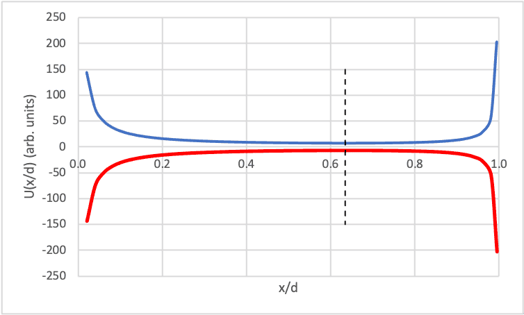

A complementary and instructive approach might be to plot the potential energy of the third bead as a function of the reduced distance ##x/d## in the region ##0<x/d<1##. Make two plots, one assuming that its charge is ##q_3=q## and one assuming that ##q_3=-q.## See how the two plots differ with regards to the equilibrium position. I recommend using a spreadsheet, not sketches drawn by hand.

Shown below is a plot of two curves. The blue line shows the potential energy when the third charge is positive and the red line when it is negative. The abscissa (x-axis) is the distance of the third bead from charge ##3q## divided by the overall distance ##d##. When ##x/d## is equal to zero, the third bead is at the charge ##+3q##; when it is equal to 1 the third bead is at charge ##+q##. The dashed line marks the position where the net force on the bead is zero.
Look at the two plots. You know that the net force on the third bead is the negative slope (or gradient) of the potential energy. If you displace the bead from the dashed line in either direction, which curve predicts a net force that will return the third bead towards the equilibrium position and which curve predicts a net force that will push the third bead away from the equilibrium position?
Thanks kuruman for the graph. I think the blue curve is the curve that will return the third bead towards the equilibrium. The potential energy in both ends of the curve is positive. This means the third bead will have a tendency to move from positive potential energy to zero, the place of equilibrium. Honestly, I'm not sure what a negative potential energy actually implies about the behavior of the bead to the system.
