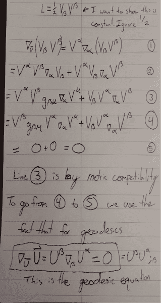

Thank you again! I think I figured it out. I don't know why latex is not working for me. Here's my
solution. I am quite familiar with the terms metric and Killing Vectors, in fact Killing vectors are symmetries of the metric. Pervect, what do you do your research in?
It's much simpler :-). Start from
$$L=\frac{1}{2} g_{\mu \nu} \dot{q}^{\mu} \dot{q}^{\nu}.$$
It's not explicitly dependent on the parameter (which is affine automatically, as we'll show right now) and thus variational calculus tells you that with the canonical momentum
$$p_{\mu}=\frac{\partial L}{\partial \dot{q}^{\mu}}$$
the "Hamiltonian"
$$H=p_{\mu} \dot{q}^{\mu}-L=\text{const},$$
and since ##g_{\mu \nu}## depends only on the ##q^{\alpha}## but not on the ##\dot{q}^{\alpha}## you simply have
$$p_{\mu}=g_{\mu \nu} \dot{q}^{\nu}.$$
This implies that
$$H=L=\text{const},$$
and this means that ##\lambda## is automatically an affine parameter.
The good thing with that is that with this form of the Lagrangian for the geodesics you can treat the timelike (massive particles' trajectories in the given spacetime) and lightlike (mass less particles, aka "naive photons") geodesics on the same footing. For timelike geodesics you can always set ##\lambda=\tau## (where ##\tau## is the proper time of the particle), while for lightlike (null) geodesics ##\lambda## is an arbitrary affine parameter, defined only up to a scale, which however is irrelevant for all the physics you can do with null geodesics.

Thank you Vanhees71! This is a wonderful and easy to follow proof.
I don't regret what I came up with, because I learned (and re-learned) a lot, but your proof is far better! Thanks again!
Case closed!
