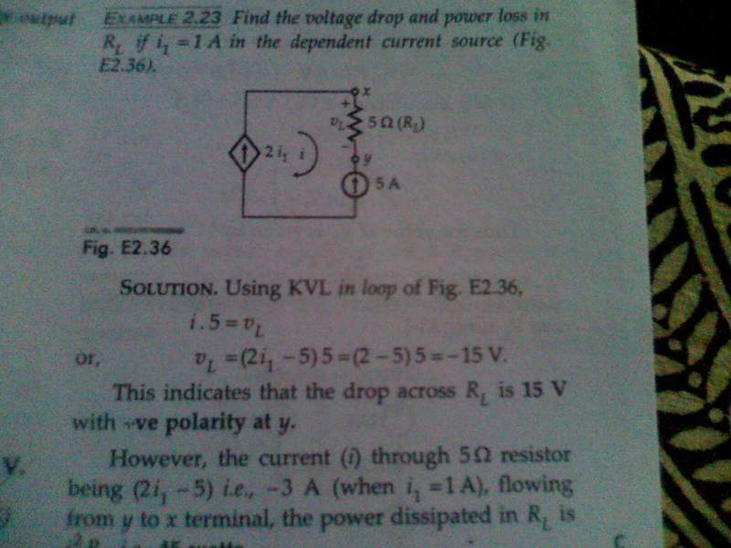

hello, forum members. I'm new so pardon if any error.
IS the question in this pic solved correctly.

The pic shows a single loop with two current sources and a resistor.
The current sources oppose each other - one (2i1) may be intended as an AC current source, while the other (5A) is a DC current source.
You can check the working yourself by applying Kirkoffs laws.
Likes 1 person
isn't
i = 2i1 = -5
This question doesn't make sense to me. A 5 amp current source has 5 amps going through it, or it wouldn't be a 5 amp current source. The same goes for the other current source. If the currents aren't equal, one or both will deviate significantly from being an ideal current source, and you'd have to know more details of the current sources to see what will happen.
Likes 1 person
@willem2, I too find it contradicting, i just neglected the question, as per me, it should be i = 2i1 = -5
I don't think the entire question is there ... it seems to be assuming a context not on the pictured page.
