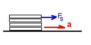

Problem A: A stack of dinner plates on a kitchen counter is accelerating horizontally at 2.7m/s^2. Determine the smallest coefficient of static friction between the dinner plates that will prevent slippage.
Fnet=ma=sum of all forces
Friction=(u)(Fn)
For problem A, the wording makes no sense. If they are accelerating, are they not slipping? Static friction only applies when the object is at rest, and the plates are not.
The problem means the plates do not slip on each other, that is the whole stack accelerates together. What force accelerates the topmost plate?
ehild
The force of static friction does, right? Because its friction on the top plate keeps it on top of the stack.
Yes. And what should be the magnitude of the static friction so as the plate accelerate with 2.7 m/s2?ehild
Fnet=Ff(static)? :)
Ff=ma
Then solve
Yes, knowing that Ff(static)≤μgm...
ehild
The question should make clear that the acceleration results from a horizontal force applied to the lowest plate. Otherwise there is insufficient information.
