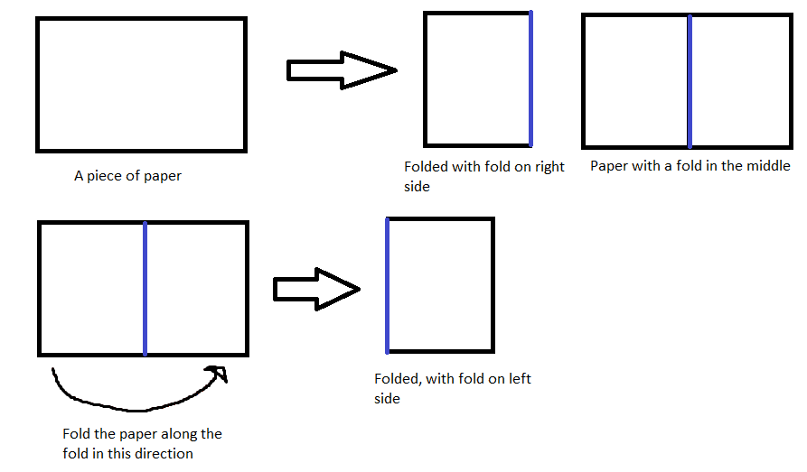

There is a way to "flip" this straight-edge* over, in such a way that edge doesn't move. It seems to me that coming up with this way of flipping the straight-edge solves the problem.
(*) The folded sheet of paper.
SammyS said:
What if you just leave the sheet of paper folded over, without cutting it?
Is it this way of flipping as described in the picture?
244507
LittleRookie said:
Is it this way of flipping as described in the picture?View attachment 244507
Yes.
So, does any part of the blue line move when doing this?
It didn't move a single bit. I understand now, thanks.
