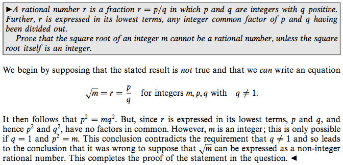

In summary, the proposition that integers ##p## and ##q## having no common factors implies ##p^2## and ##q^2## have no common factors can be proven without using the fundamental theorem of arithmetic, but the proof hinges on the definition of primes and coprime numbers. However, the proof provided by the book may not be complete without invoking the fundamental theorem.
Happiness
690
31
Integers ##p## and ##q## having no common factors implies ##p^2## and ##q^2## have no common factors. Could you prove this without using the fundamental theorem of arithmetic (every integer greater than 1 either is prime itself or is the product of prime numbers, and that this product is unique, up to the order of the factors)?
Note that this isn't the same as saying integers ##p## and ##q## having a common factor implies ##p^2## and ##q^2## have a common factor, which is straightforward.
The above proposition is obtained from the following proof (last paragraph, line 1). I believe the book does't use the fundamental theorem of arithmetic because if it does (implicitly require it for the above proposition) then it might as well use it right from the start for the following proof, i.e., let ##m## be a product of primes.
Note that ##p^2## has more factors than ##p##. For example, ##12## is a factor of ##p^2=36## but not of ##p=6##. That's why the proposition is not immediately obvious.

But ##p## and ##q## don't need to be prime, they only need to be coprime.
But your argument does make some progress. ##p^2## and ##q^2## cannot have a common divisor that is prime. Otherwise, that prime divisor will divide both ##p## and ##q## and we have a contradiction. But what is required for the proof is that ##p^2## and ##q^2## cannot have any common divisor.
How about this:
##p## and ##q## being coprime means there are numbers ##x,y## such that ##1=xp+yq##. Let us assume ##a## divides both, ##p^2## and ##q^2.##
Thus ##a \, | \, xp^2 = (p - ypq)## and ##a \, | \, xp^2q = (pq - ypq^2)##. Because ##a \, | \, q^2## it has to divide ##pq## as well. Therefor ##a## has to be a unit.

I don't follow the last part. Why must ##a## be unity if it divides ##pq##?
You're right. I assumed ##a## to be prime which I must not do without using the theorem. Seems to be more complicated than I first thought. Surely one has to use the argumentation of the theorem' proof somehow without using the result. Let me have a closer look.
Edit: If ##a \, | \, pq## then ##a \, | \, 1 = 1^2 = (xp+yq)^2 = x^2p^2 + y^2q^2 + 2xypq,## i.e. ##a## is a unit.

Then I think the proof provided by the book is not a good one, because using the fundamental theorem of arithmetic right from the start is more straightforward, i.e., letting ##m## be a product of primes and then arguing that if ##\sqrt{m}## is rational then ##\sqrt{p_i}## is also rational, where ##p_i## is one of the primes in the prime factorisation of ##m##, which soon leads to a contradiction.
Then the proof provided only looks simple but it's actually not complete without invoking the fundamental theorem of arithmetic. In other words, it look as though it is simpler than those methods that use the fundamental theorem of arithmetic, but it's actually not.
I'm not quite sure whether the equivalence between ##p## and ##q## are coprime and the existence of the equation ##1 = xp +yq## already uses the theorem. One could define coprime this way, but one can as well define it by there is no proper common divisor.
The question essentially comes down on: "Does the Euclidean division implicitly make use of the fundamental theorem of Arithmetic?"
I don't think so but I'm not sure.

Good job.
But I doubt this is what the author had in mind when he wrote his proof because he didn't introduce the Bezout's identity or the fundamental theorem of arithmetic in any preceding sections. Probably he overlooked the fact that either one (or something else equally or more advanced) has to be used in his proof.
He must have ironically made an inverse error, having warned readers about it in the next section.

The proof in the book states without further note that "##p## and ##q##, hence ##p^2## and ##q^2## have no common factors". This depends on the FTA. Also, this is essentially the proof in a nutshell, as it shows that proper rationals square to proper rationals, never to whole numbers. QED
Can we start from [itex]a|p^2[/itex], then [itex]a=b^2[/itex], where b is an integer? If so assume a divide both squares, then b divides both.
as suggested above, it does not use the FTA to say that two integers n,m are relatively prime iff there exist integers a,b with an+bm = 1. then cubing this equation gives 1 = a^3n^3 + 3a^2n^2bm + 3 anb^2m^2 + b^3m^3 = n^2X + m^2Y, so n^2 and m^2 are also rel prime.
What do you mean? How do we get a simpler proof than the book's by beginning with the assumption that ##m## is a product of primes?
As has been pointed out, the proof in the book does depend upon the fundamental theorem of arithmetic.

The part in bold is the essence of your proof, which should be proved, not just stated. Are you using the fundamental theorem of arithmetic subconsciously?
Your proof can be fine tuned by using the fact that if a prime number ##b## divides ##cd## then it divides ##c## or it divides ##d##. Apply this to your proof, we have ##m## divides ##p^2## so ##m## divides ##p##.
But this is only true when ##m## is prime. We have not fully generalized the proof to all integers ##m##.

How do you know that "if ##\sqrt{m}## is rational then ##\sqrt{p_i}## is also rational, where ##p_i## is one of the primes in the prime factorisation of ##m##"?
I think that if you include a proof of that in a proof of the proposition in the book, you get a proof which is not significantly simpler than the proof in the book. Try to write down your own proof of the proposition in the book, and you will see...
In both cases, the fundamental theorem of arithmetic is used, at least implicitly.
I didn't say my proof is simple. I said it is more straightforward. And my proof doesn't use the fundamental theorem of arithmetic implicitly, it uses it openly!
The author most likely made an inverse error when he wrote down his proof.
Btw, "if ##\sqrt{m}## is rational then ##\sqrt{p_i}## is also rational, where ##p_i## is one of the primes in the prime factorisation of ##m##" is wrong in general.
##\sqrt 4## is rational and ##2## is a prime factor of ##4##, but ##\sqrt 2## is not rational.
You can probably express what you mean more precisely and get it right, but will you then really get a proof of the proposition in the book which is simpler, or more straightforward, than the proof in the book?
