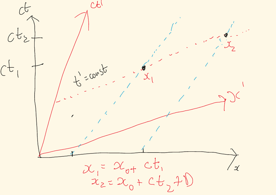

Two light sources are at rest and at a distance D apart on the x-axis of some inertial frame, O. They emit photons simultaneously in that frame in the positive x-direction. Show that in an inertial frame, O', in which the sources have a velocity v along the x-axis, the photons are separated by a constant distance $$D\sqrt{\frac{c-u}{c+u}}$$
$$x_2-x_1 =D$$
I let E1 be the event where source 1 emits the photon and E2 for the second source with the respective coordinates in O as $(x_1, t_1$) and $(x_2,t_2)$ such that $t_2=t_1 \because$ simultaneous and $x_2-x_1 =D$.
Using Lorentz transformation I obtained that in O', $$x'_2-x'_1 = \gamma (D-v(t_2-t_1))=\gamma D \ \because t_2 = t_1$$ In the solutions $$t_2-t_1 = \frac{D}{c} $$ however I cannot see where this came from.

Oh so actually it's ## t'_1 = t'_2 ##, so in that case, ##x_2-x_1 = D + c(t_2 - t_1 ) ## as both sources would emit light simultaneously and hence
$$x_2'-x_1' = \gamma (D + c(t_2 - t_1) - v(t_2 - t_1)$$ and since in O', the event is simultaneous, I got
$$t_2'-t_1' = 0 = \gamma \[ t_2 - t_1 - \frac{v}{c^2} (D + c (t_2 - t_1)) \]$$
which simplifies to $$t_2 - t_1 = \frac{vD}{c(c-v)}$$
Hence substituting for ##t_2 - t_1## I got
$$x_2' - x_1' = \gamma (D + \frac{vD}{c-v} - \frac{v^2 D }{c(c-v})$$
$$x_2' - x_1 ' = \gamma D \frac {c+v}{c}= D \sqrt {\frac{c+v}{c-v}}$$
Did I commit some algebraic mistake or perhaps + and - as an answer were mistaken?

Have you seen the derivation of length contraction? In any case, you need to be more careful about using ##D = x_2 - x_1##. That's only true if ##x_1, x_2## represent the sources at the same time in the unprimed frame. If you take events which are simultaneous in frame ##S'##, they do not map to events that are simultaneous in frame ##S##, hence do not map to events where ##x_2 - x_1 = D##.
You need to take more care.
In relation to the attached diagram, I described the position of ##x_1, x_2 ## and hence took their difference, and transformed it to the primed reference frame where ##t' = ## constant
You have too many constraints there: you demand that ##x_2 = x_1 + D## and that ##t'_1 = t'_2##. You cannot have both those equations:
$$t'_1 = t'_2 \ \Rightarrow \ t_1 \ne t_2 \ \Rightarrow \ x_2 \ne x_1 + D$$
PS this is even clearer if you take the first event to be the (common) origin of the frames. Then the second event is: ##(0, D)## in the first frame and ##(t'_2, x'_2)## in the second frame, where ##t'_2 \ne 0##.
If you want ##t'_2 = 0##, then you need to choose a different event: ##(t_1, x_1)## where necessarily ##t_1 \ne 0## and ##x_1 \ne D##.

Yes, the way I worked it out was by letting ##x_2 = x_0 + D + ct_2 ## and ##x_1 = x_0 + ct_1## so that ##x_2 -x_1 = D + c(t_2 - t_1) ##
I did it in the first case so that
$$x_2'-x_1' = \gamma (x_2 - x_1 - v (t_2 - t_1) = \gamma D \because t_2 - t_1 = 0 $$ but the final answer impliesthat $$t_2-t_1 = \frac{D}{c} $$
Okay, yes I see that now. Apologies.
You may have done the wrong transformation. The sources are the "moving frame", so you want the inverse transformation.
