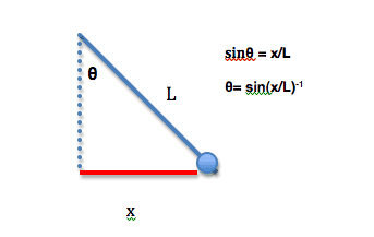

Can I then use the formula h= sqrt(0.95^2 -x^2) to find the horizontal distances the marbles travel (see the diagram again). and then use the length of the string and x to find the angle?
Ok, I attached a diagram showing how I used x and L to find theta for each marble. Is this logical?
Thanks for takin the time :)
redraw the diagram of the final positions with all the heights that you know and all the lengths that you know.
Does it look simpler now?
Hint try to make a 1/10th scale drawing , don't forget to use a compass.
Pheobz, I can see you have added a triangle and want to calculate a horizontal displacement. But do you need that horizontal displacement, since its not part of the answer you have to give?What lengths do you know? What heights do you know? What do you know about the shape of the paths of the two marbles? where are your heights measured from?
If you don't have a compass use a bit of string tied around a pencil. If the algebra/ trigonometry is unclear then often the best way to see a way forward is to make a drawing. Geometry really can help you here.
I found the horizontal displacement so that I could find the angle theta, I found 'x' using the formula h= L- sqrt(L^2-x^2). Then I went sin(theta) =x/L to find the angle for each marble, does this work?
And thank you TSny, I think I have the right value for the small marble now, 0.028m!
what is the relationship between
string length x cosine(theta)
and h
They add together to make the adjacent side of the angle?
I tried going cos(theta) = [L cos(theta) +h] /L
but the Lcos(theta)s both cancel out :s
There is something wrong with your equation..
what does L cos(theta) + h add up to?
The the length of the string? I am really not sure :s, I thought I had it figured
Right.
When comparing the raised position to the bottom position, the length of the string is of course the same. What differs is the height. What's the vertical distance below the pivot point (the ceiling) in each case? Use that to figure out the height h.
Awesome! I finally think I have it! Thank you everyone :D
