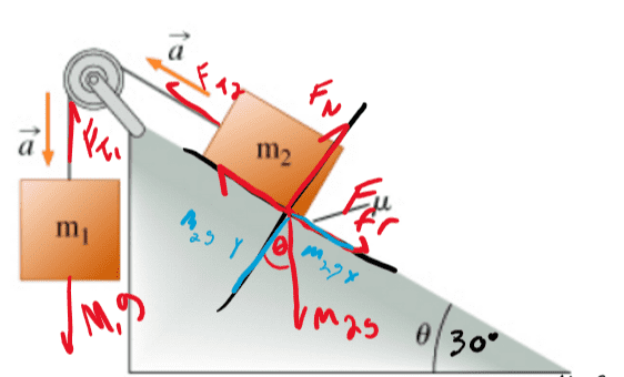

Block 1, of mass m1 = 0.700 kg , is connected over an ideal (massless and frictionless) pulley to block 2, of mass m2, as shown. For an angle of θ = 30.0 ∘ and a coefficient of kinetic friction between block 2 and the plane of μ = 0.350, an acceleration of magnitude a = 0.200 m/s2 is observed for block 2.
Find the mass of m2.

This is where your problem is
[m2]ΣFx=m2gsinΘ+μFn-T=m2a
Up the incline (direction of acceleration a) is assumed positive as shown on the RHS.
m2gsinΘ and μFn must be negative because they are down the incline
T must be positive because it is up the incline.
Or you could just change the sign of the acceleration in this equation and leave the LHS alone.
