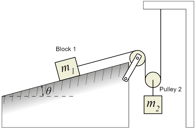

A block of mass m1 is at rest on an inclined plane that makes an angle (theta) with the horizontal. The coefficient of static friction between the block and the inclined planed is µs. A massless, inextensible string is attached to one end of the block, passes over a fixed pulley, pulley 1, around a second freely suspended pulley, pulley 2, and is finally attached to a fixed support. The pulleys are massless, but a second block of mass m2 is hung from the suspended pulley. Gravity acts downwards.
Now assume that the block on the incline plane is sliding up the plane. The coefficient of kinetic friction is µk. Find the magnitude of the acceleration of the block on the inclined plane a_x1 Express your answer in terms of some or all of the variables m1, m2, theta, µk and g

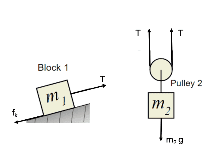

I choose coordinate systems. For block 1 I chose the positive X axis downward along the surface of the inclined plane and the positive Y axis up, perpendicular to the surface of the inclined plane with the x origin at the top of the incline. For block 2 I chose the positive Y-direction downwards with the origin at the ceiling.
I made free-body diagrams of both block 1, 2 and the suspended pulley which gave me the following equations:
I can treat the suspended pulley and block 2 as one system because the length between them is constant so they move with the same acceleration a_2

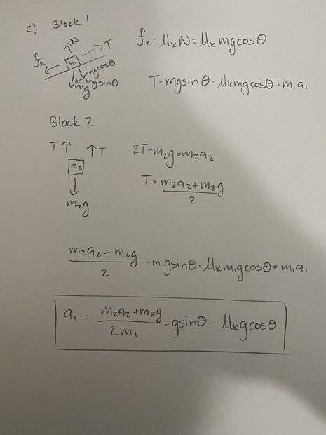

-T + µ_k m_1 gcos(theta) + m_1 gsin(theta) = m_1 a_x1
N = m_1 gcos(theta)
-2T + m_2 g = m_2 a_2

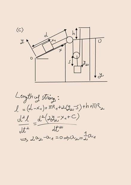

The length of the cord connecting block 1 with the ceiling is constant. So after taking two derivatives of the length. I get the relation between a_x1 and a_2 which is a_1 = -2a_2

For some reason this answer is not correct and I have been looking for that reason for several hours but I can't seem to find it. I think its a math error rather than a physics error. Can someone help me out?
Looks like you have signage errors. You have one block moving down the plane and the other hanging block moving downward. If the hanging block moves down the other moves up the plane, as stated. Acceleration of each block is in the direction of the net force.
So the acceleration of block 1 has a negative sign and the acceleration of block 2 has a positive sign. Then,
-T + µ_k m_1 gcos(theta) + m_1 gsin(theta) = m_1 a_x1 should be -T + µ_k m_1 gcos(theta) + m_1 gsin(theta) = - m_1*a_x1 ?
Yes , and a2 is one half of a1.
Ok, I think I got it. a_1 = (2*(µ_k*m_1*g*cos(theta) + m_1*g*sin(theta))-m_2*g ) / (-m_2/2 - 2*m_1)
Yes that looks correct. I find it easier to assume the positive direction in the direction of the acceleration, positive up incline for m1 and positive down for m2. Helps a bit with signage errors

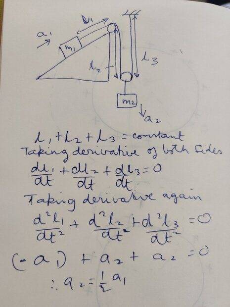

Is ##a_2= \dfrac {a_1} {2}## because mass ##m_2## moves half the distance that mass ##m_1## moves in the same interval?
@vcsharp2003 that can be explained using "constrained motion", making use of the fact that the string is inextensible, so its length is constant. Writing the string's length in terms of motion functions of the objects and other constants, we get the identity. Would you like me to post the actual proof so you can understand better?
I think I got it as shown below.
In analysis below, ##l_1##, ##l_2##, ##l_3## are instantaneous lengths of respective sections of the string, while
##a_1##, ##a_2## are the instantaneous accelerations of masses ##m_1## and
##m_2##.

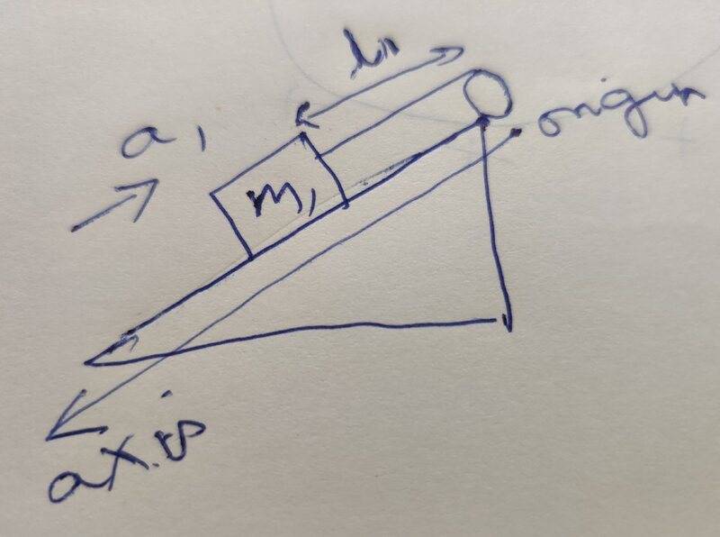

I am not very clear why I wrote ##\dfrac {d^2l_1} {dt^2} = -a_1##. I know that ##l_1## is decreasing with time and so ##\dfrac {dl_1} {dt}## is negative.
Because you are measuring a1 as positive up the slope but the distance of that mass from the pulley, l1, as positive down the slope.
You mean the origin of the axis for the ##l_1## axis is at top pulley and I have assumed ##l_1## to be positive so the positive direction of axis is pointing down along the plane?
vcsharp2003 said:
You mean the origin of the axis for the ##l_1## axis is at top pulley and I have assumed ##l_1## to be positive so the positive direction of axis is pointing down along the plane?https://www.physicsforums.com/attachments/288104
I mean because an increasing value of l1 would mean the mass is sliding down, so implicitly you are measuring the displacement of the mass from the pulley as positive down the plane.
I see.
I think it's very important to define the axis with origin and direction when analysing kinematic situations else signs can get messed up.

You are on the right track, to some extent. When tackling constrained motion problems, it is very important to clearly define coordinate axis for each object, as things can easily overcomplicate. Take a look, for example, at the system of pulleys I have attached, and think of how you would solve it.
In my approach I have chosen for object 1 an axis with origin at distance d away from pulley 1, and for object 2 an axis that is at height h below the ceiling. I denoted the small string between pulley 2 and object 2 with s. When considering the length of the string I have not neglected the part wrapped around the pulleys, which is also constant.
These steps are not necessary here, however in the future treating everything carefully will bring you benefits.

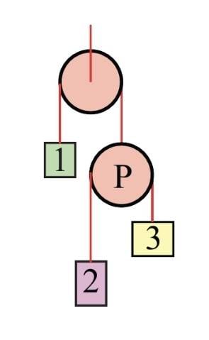

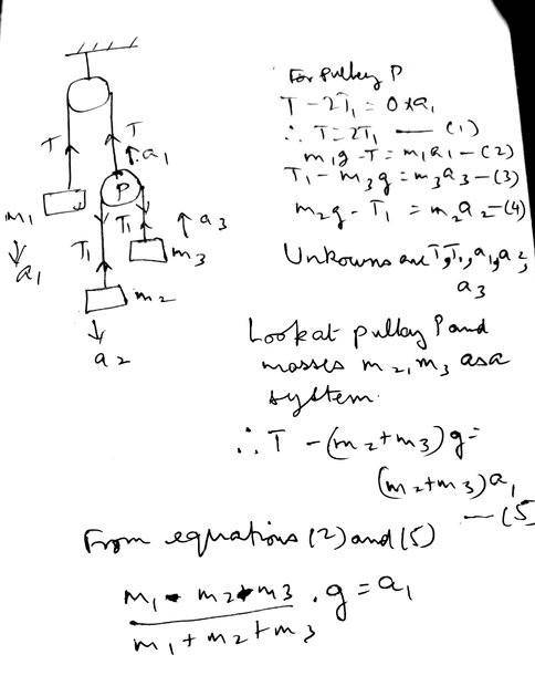

Is the pulleys masses diagram a part of some question? It looks like a challenging problem and worth trying/learning from it.
We assume the positive direction of vertical axis to point downwards and origin to be at center of pulley P when looking at the masses 2 and 3.
If the mass 1 on left side moves down by x units then the pulley P will also move up by x units. Therefore, mass 1 and pulley P have same accelerations.
Regarding masses 2 and 3, it gets challenging. Let's say the mass 3 moves up by z units relative to pulley P, then mass 2 will move down by z units relative to pulley P. So relative to ground, mass 3 will move up by x + z units and mass 2 will move down or up by z- x or x- z units. So masses 2 and masses 3 will also not same accelerations as distances traveled by them are different in a certain time interval. We would therefore end up with 3 different accelerations as unknowns in this situation.
The solution is as shown below. Once we have ##a_1##, then by substitution in other equations we can determine ##a_2## and ##a_3##.

Yes, the system is from an MIT problem. If you are interested, I have a very good resource of problems and explanations from an MIT OCW.
The first 4 equations are OK, but the 5th one is RIP. We cannot consider the acceleration of a system of objects, only if we consider that to be a non-inertial frame and consider the fictitious force, which messes up the problem in this case.
I have attached a PDF with the full solution.
I think that the equation (5) is ok because we have the system of pulley and the hanging masses in black box move up with acceleration ##a_1## relative to ground. Is that correct? The acceleration of internal parts of this system is not needed but just the acceleration of whole system.
I understand your intuitive logic, but here's the thing.
Whenever you have objects that are considered massless (pulleys / strings), avoid grouping them into systems of objects, because you risk getting such contradictions. In this case it's the fault of pulley P which you have to treat separately, because it's massless. When you group it with other objects, you jump over using this fact. You can compare it to dividing by x in an inequality, but you don't know if x is positive or not, and you dilute that information and you get to something wrong.
As you can see, according to equation (8.6.69) (which I also arrived to when solving the problem), the final answer is not conclusive with yours.
This is mainly the problem with "ideal physics" where you have to make some assumptions, because otherwise it will be insanely hard to treat everything (ignore mass and friction for rope/pulley, ignore drag force in air falling, consider uniform density, sin x = x for the pendulum, also known as fundamental theorem of engineering). And when you make such assumptions sometimes they turn against you. Hope you understand it.
I was comparing it to a plane that is moving on the runway. Passengers inside could be walking relative to the plane, but Newton's second law could be applied to the plane using the total mass of passengers and plane as the m term in F=ma equation.
