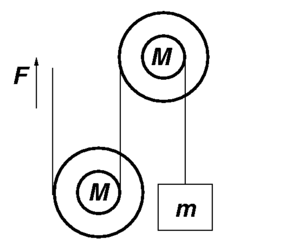

Each pulley is replaced by a system of two concentric disks, which are fastened
together and are free to rotate about a fixed, common axle. Each system has mass
M and moment of inertia MR2/2, and the radius of the inner disk is R/2 and that
of the outer disk is R. Light, inextensible strings of the same material as in part (d)
are wrapped around each disk system, as shown in the diagram below, and the same
block of mass m is to be lifted by the force of magnitude F. Find the maximum
possible acceleration of the block in this case.
t=Iα
F=ma
I solved the last part of the previous question, But I got no idea how to start solving this question Like how the rope is being attached, is it attached to the inner disk or the outer one.

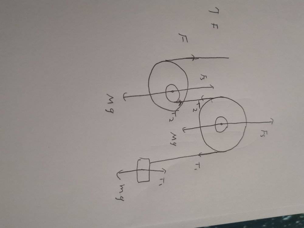

This is the FBD that I think about
I think the position of the mass I drawn it wrongly

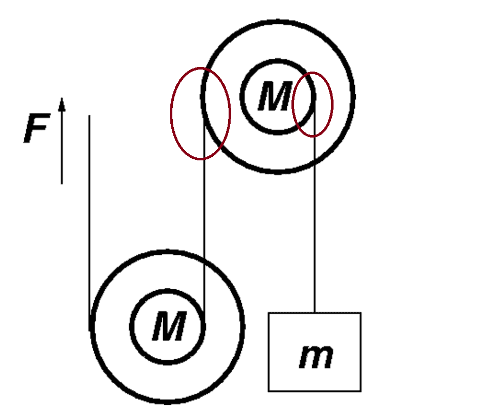

The rope that connects the pulleys runs from the outer disc of the upper pulley to the inner disc of the lower pulley. The determines the relationship between the two angular accelerations.

There are three separate ropes.
Sorry but how do we know that they are separate ropes
The diagram shows a rope from the suspended mass rising up to and wrapping around the inner disc of the upper pulley. It does not show that rope going anywhere else, and if it did things would get in a tangle.
It also shows a rope wrapping around the outer disc of the upper pulley and the inner disc of the lower pulley. Again, it is not shown continuing anywhere beyond.
The question says
"Light, inextensible strings of the same material as in part (d) are wrapped around each disk system"
Strings, plural.
Won't the middle rope for both of them have the same tangential speed, so for each pulley their will be two tangential speed one of each rope
If the middle rope on the left hand pulley has speed v, what is the speed of the outer rope on the right hand pulley?
Since they are the same rope, this should be an easy question to answer.
