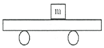

We have a cart (It is very long) and a box on it.They are at first stationary but at ##t=0##, cart begins to move with ##v## such that:
##v = \alpha t^\beta ; t\leq t_0## and ##\dot v = c; t>t_0 ##
where ##\alpha ,\beta ,c## are constants.
At the time ##t1 (t_1<t_0)## the box is at the verge of movement (I don't know the exact translation of this in English, it means that at ##t_1 + \delta t## (very small ##\delta t>0##) it will move). At the (t_2 > t_0) it will get stationary relative to the cart (both move at the same speed).
I)Find dimension of ##\alpha,\beta,c##
II)Find ##c## in term of ##\alpha, \beta , t_0##
III)Find ##\mu_s ,\mu_k## (Static and Kinetic coefficient of friction) between box and cart.
IV) Find the distance the box traveled on the cart between (t_1 to t_2).
I) For the first part, we can simply find that ##\beta## is dimensionless, ##v = L / T##so ##alpha = L * T^ -(\beta +1) ## also c is ##L / T^2##
II) we can say that at ##t = t_0## the accelerations must get equal (Because it's physics, not some strange math functions) so ##\alpha \beta t_0^{\beta-1} = c##
III) We can say that at ##t_2## we have static friction and acceleration of cart and box are equal, so ##\mu_s g = c## and we get ##\mu_s = c/g##. I don't know how to find ##\mu_k## and also how to solve part IV .

First about ##t_1##; the whole movement and question started at t=0. So I think it is obvious that this must be greater than 0.
About the second part, I think it starts to move relative to inertial frame at that time and not the Cart. the issue is that it's all the question gives and nothing more. I don't know the exact translation of the verge of movement in English, but for example think you are pushing something on floor with static friction coefficient ##\mu_s##, when ##F = mg\mu_s## I say it is at the verge of movement and when ##F > mg\mu_s## it moves. Except from this, It is all of the givings and assumptions of the question. It doesn't have anything else. It is from "General Physics 1" Midterm exam of the best technology university in Iran (Sharif University of Technology).
I also added the picture of the question, although it doesn't have anything useful.

titansarus said:
First about t1; the whole movement and question started at t=0. So I think it is obvious that this must be greater than 0.
I agree it implies t1>0, but I do not see how the box can remain stationary in the lab frame after the cart has started to move.
If instead we suppose it means on the verge of slipping, we can find μs in terms of t1, α and β.
We are not told whether β is more or less than 1. If less, the acceleration of the cart is infinite at t=0 and the box must start to slip immediately. So let us suppose β>1.
For the box to slip at all, the peak acceleration of the cart must exceed what the static friction can deliver. If the acceleration is continuous through t0, as you presumed, the acceleration never falls below that peak, so the speeds will never match.
Have you tried to sketch the acceleration-time graph of the cart?
