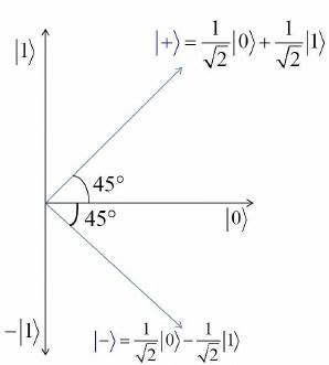

Here is his example from the paper. It shows two orthogonal bases. The ##|0\rangle |1\rangle## basis and the
##|+\rangle |-\rangle## basis. There is no question that the two bases shown do not commute.
The figure shows the ##|+\rangle |-\rangle## basis oriented at 45° to the ##|0\rangle |1\rangle## basis. If we rotate the ##|+\rangle |-\rangle## basis by some arbritary amount (but less than 45°) will the two bases still not commute? For any angle, except an angle that would make the two bases equal, shouldn't we expect the two not to commute?
What is special about the two bases shown in the figure that, you agree, do not commute?

We can write the ##|+\rangle |-\rangle## basis as
\begin{equation}|+\rangle = \cos(\theta)|0\rangle + \sin(\theta)|1\rangle |\rangle\end{equation}$$|-\rangle = \cos(\theta)|0\rangle - \sin(\theta)|1\rangle |\rangle$$What is special about ##\theta=45^\circ## that makes that particular orientation of the ##|+\rangle |-\rangle## basis non-commutative with the ##|0\rangle |1\rangle## basis?
Yes. But this is a property of the particular Hilbert space and operators that were chosen. It does not generalize to all possible Hilbert spaces and operators.

I am not so sure that it does not generalize to all Hilbert spaces. I think I can show that graphically.
When we measure a quantum entity using two different bases, it is equivalent to measuring two different properties of the quantum entity. The axis of each basis are the eigenvectors for the corresponding property. In order to know the exact value of both properties, simultaneously, the eigenvectors of the two basis have to coincide. This is to say that when the measurement of one property puts you in a collapsed state for that property (on one of its eigenvectors), that vector must coincide with an eigenvector for the other property. If it does not, then the state vector for the other property is a linear combination of it basis states and not a collapsed state for that property. This means that both properties cannot be in a collapsed state at the same time, which implies that you cannot know the exact values of the two properties simultaneously.

Your graphic applies to the particular case of the spin of a spin-1/2 particle. That is not the same as applying to all possible Hilbert spaces and operators. See below.
More precisely, one particular vector must be an eigenvector of both operators. But your reasoning assumes that once we know that particular vector, we also know a unique vector that is orthogonal to it, so that finding one particular vector is equivalent to finding a basis for the entire Hilbert space. But it should be evident that this reasoning is only valid for a Hilbert space with two dimensions (i.e., for which any operator has at most two distinct eigenvectors). For any Hilbert space with more than two dimensions, there will be an infinite number of possible sets of orthonormal vectors that are orthogonal to a given vector, so picking out a particular vector does not pick out a unique basis.
mike1000 said:
... What is special about ##\theta=45^\circ## that makes that particular orientation of the ##|+\rangle |-\rangle## basis non-commutative with the ##|0\rangle |1\rangle## basis?
Nothing. As I understand it, they will always be non-commutative unless the basis vectors of the two orthonormal measurement systems are orthonormal to each other (90 degrees sideways or verticle) and in your example, they are not.

This is false. An arbitrary unitary rotation of a basis gives another basis. But not all unitary rotations are Fourier transformation.
Two Hermitian operators can commute even if they are different in a nontrivial way because of degeneracy (repeated eigenvalues). In 2 dimensions, the only degenerate operators are multiples of the identity operator. You have to go to higher dimensions to have nontrivial degenerated Hermitian operators.
